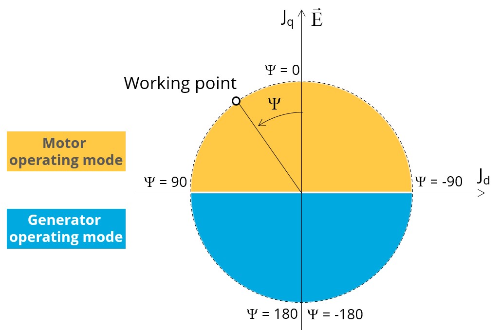

  3. Control angle
    Considering the vector diagram shown below, the “Control angle” is the angle between the electromotive force E and the electrical current (J) (Ψ = (E, J)). It is an electrical angle. It must be set in a range of -90 to 90 degrees.
    This range of values covers all the possible working point in motor convention.
    Figure 1. Definition of the control angle Ψ- Motor convention

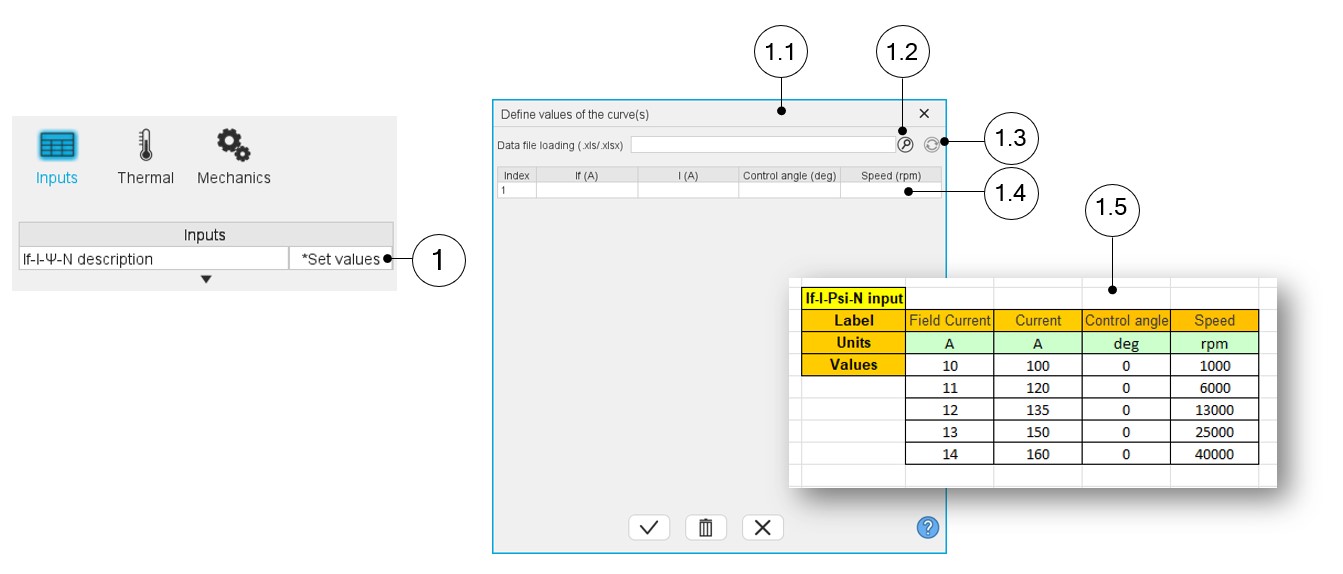

  5. Process to define the list of working points
    Table 1. List of working points to be defined
    1 Click on the button “Set values” of the field “ I, Ψ, N description” to define the working points in a dialog box. Refer to the next illustration which shows how to fill the working point table.
    1.1 Dialog box opened after having clicked on the button “Set values” in the field “Cycle description”
    1.2 Browse the folder to select an Excel file which describes the duty cycle.
    1.3 Button to refresh the table data when the considered Excel file has been modified.
    1.4 Fields to be filled with data to describe the duty cycle to be considered.
    1.5 Excel file template to define the list of working points.
