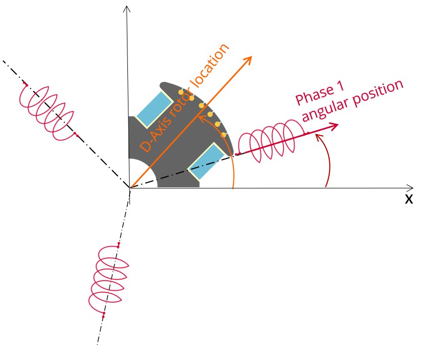

Rotor initial position
By default, the “Rotor initial position” is set to “Auto”.
When the “Rotor initial position mode” is set to “Auto”, the initial position of the rotor is automatically defined by an internal process.
The resulting relative angular position corresponds to the alignment between the axis of the stator phase 1 (reference phase) and the direct axis of the rotor.
When the “Rotor initial position” is set to “User input” (i.e. toggle button on the right), the initial position of the rotor considered for computation must be set by the user in the field « Rotor initial position ». The default value is equal to 0. The range of possible values is [-360, 360].
Notice: The computations are performed by considering the relative angular position between the rotor and stator.
This relative angular position corresponds to the angular distance between the direct axis of the rotor north pole and the axis of the stator phase 1 (reference phase).
The value of the rotor D-axis location, which is automatically defined for each saliency part.
Below is illustrated the Rotor and stator phase relative position
The relative angular position between the axis of the stator phase 1 (reference phase) and the rotor D-axis position must be controlled to perform the tests. See the picture below which will allow defining the working point of the machine.
Figure 1. Definition of rotor initial position – Rules for direction
The winding axis of the reference phase is defined from the phase shift of the first electrical harmonic of the magneto motive force (M.M.F.).

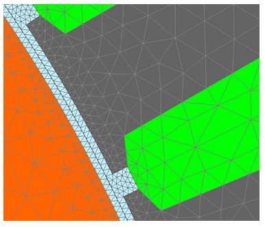

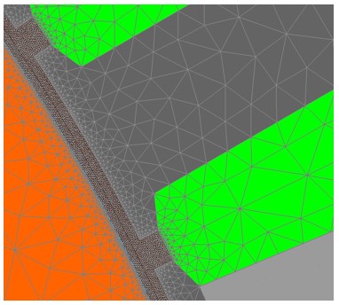

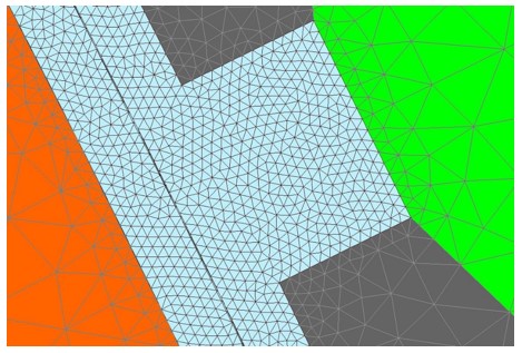

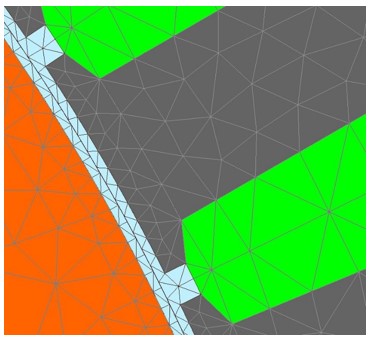

Airgap mesh coefficient
The advanced user input “Airgap mesh coefficient” is a coefficient which adjusts the size of mesh elements inside the airgap. When the value of “Airgap mesh coefficient” decreases, the mesh elements get smaller, leading to a higher mesh density inside the airgap, increasing the computation accuracy.
The imposed Mesh Point (size of mesh elements touching points of the geometry), inside the Altair Flux software, is described as:
MeshPoint = (airgap) x (airgap mesh coefficient)
0.05 giving a very high mesh density and 2 giving a very coarse mesh density.
CAUTION: Be aware, a very high mesh density does not always mean a better result quality. However, this always leads to a huge number of nodes in the corresponding finite element model. So, it means a need for huge numerical memory and increases the computation time considerably.
The impact of the airgap mesh coefficient on resultant meshing is illustrated bellow:
Figure 2. Airgap mesh coefficient = 0.45 = default value
Figure 3. Airgap mesh coefficient = 1.0
Figure 4. Airgap mesh coefficient = 0.1
Figure 5. Airgap mesh coefficient = 0.1 (zoomed view)

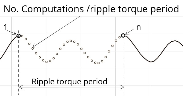

No. comp. / ripple period
The number of computations per ripple torque period is considered to perform a “Ripple torque analysis”.
The user input “No. comp. / ripple period” (Number of computations per ripple torque period) influences the accuracy of results (computation of the peak-peak ripple torque) and the computation time.
The default value is equal to 30. The minimum allowed value is 25. The default value provides a good compromise between the accuracy of results and computation time.
Figure 6. Definition of the number of computations per ripple torque period

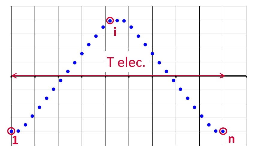

No. comp. / elec. period
The number of computations per electrical period “No. comp. / elec. period” (Number of computations per electrical period) influences the accuracy of results and the computation time.
The default value is equal to 40. The minimum allowed value is 13. This default value provides a good compromise between the accuracy of results and computation time.
Note: The real number of computations per electrical period can be equal to the requested one +/- 1. That is due to our internal computation process since the raw computation is performed over one electrical half period. The result of a whole electrical period is rebuilt from the raw data.
Figure 7. Number of computations per electrical period

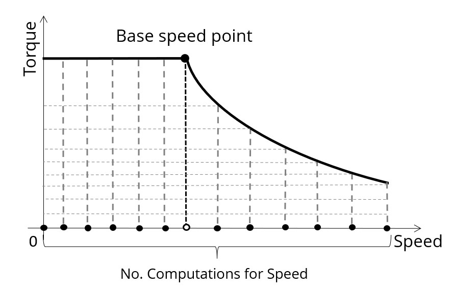

No. comp. for speed
The “No. comp. for speed” (Number of computations for speed) corresponds to the number of points to be considered in the speed range from 0 to the maximum speed.
Half of these points are distributed from 0 to the base speed. The remaining points are distributed from the base speed to the maximum speed.
In both cases, base speed is considered as an additional point.
Note: If the user input parameter “No. comp. for speed” is an odd number, one discretization point is automatically removed.
Figure 8. Definition of the number of computations for speed
The default value is equal to 15, the minimum allowed value is 5. The maximum recommended value is 40.

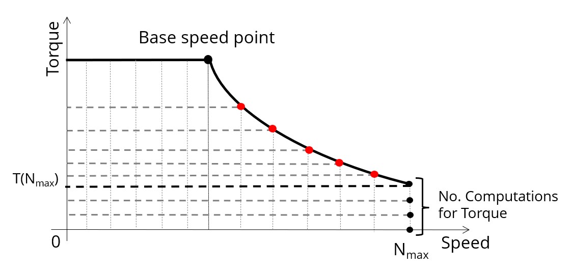

No. comp. for torque
For the speed range [Nbase; Nmax.], the number of computations for torque is imposed by the number of computations for speed in the speed range [Nbase; Nmax.] (Red points in the image shown below).
The advanced user input parameter “No. comp. for torque” allows to finalize the grid within the torque range [0, T (Nmax.)] at the maximum speed (Black points in the image shown below).
The default value is equal to 7. The minimum allowed value is 3. The maximum recommended value is 20.
Figure 9. Definition of the number of computations for torque – MTPV command mode

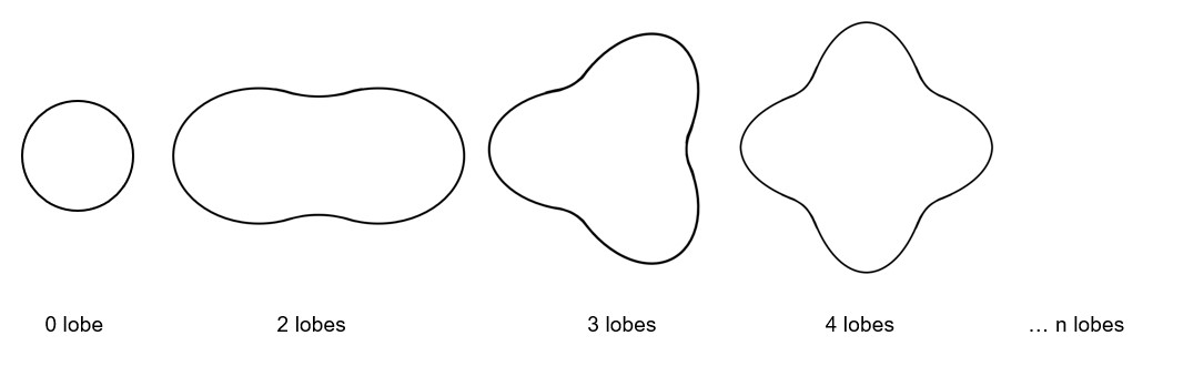

Max. mode / spatial order
The “max. mode / spatial order” (Maximum mode / spatial order) input allows the user to define the number of modes to be considered for the acoustic structural analysis. If the user selects 25, it means that the highest number of lobes in the stator deformation will be equal to 25 lobes. All deformations corresponding to more than 25 lobes will be dismissed.
Figure 10. Number of lobes of the stator mechanical structure
