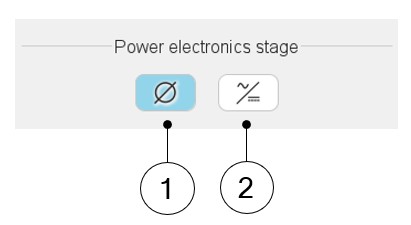

A dedicated dialog box allows the user to operate the motor with power electronic stage or without power electronic stage.
The following tests are concerned by this feature:
Table 1. Power electronics stage
1 Button to not consider power electronics stage (=default mode)
2 utton to define the user parameters of the power electronic mode
When available, the selection of the “Power electronics mode” gives access to a dedicated list of user input parameters.

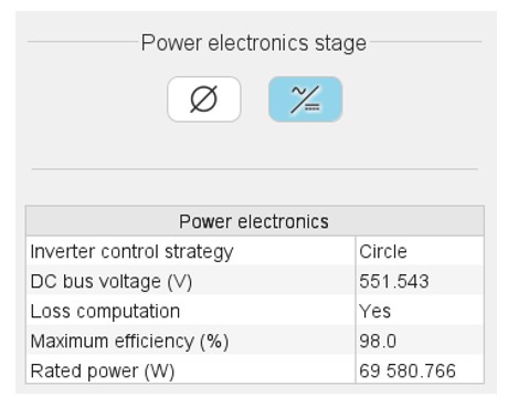

The number of user parameters to define depends on the selected test.The whole list of power electronics parameters is illustrated below.
Figure 1. Power electronics mode - Whole list of input parameters

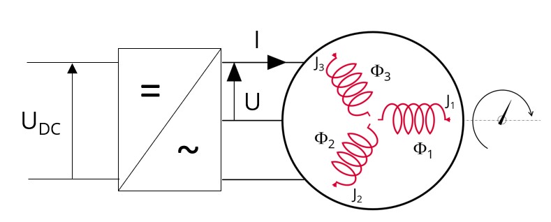

    Figure 2. Voltage and current inputs of the power electronics stage and electrical machine
    The chosen inverter control drives the ratio between the DC bus voltage and the line-line voltage seen at the machine terminal. This ratio is defined as:
    Where UDC is the DC bus voltage before inverter stage and Urms is the rms value of the first harmonic of the line-line voltage at the terminal ends of the machine.

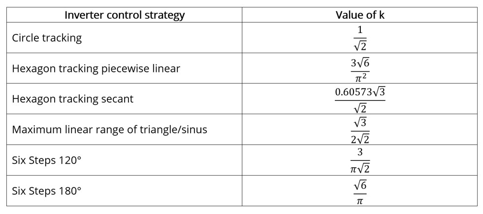

    The considered inverter control strategies and their corresponding values of k are listed in the table below.
    Figure 3. Inverter control strategy
  2. Loss computation
    An internal process allows evaluating the power dissipated in the power electronics stage and its efficiency.
    To get the result of this computation the user input Loss computation (Power electronics loss computation) must be set to “Yes”. The default value is “No”.
    When this input is set to “Yes”, the computation of power electronics losses and efficiency is performed based on two other parameters to define: The maximum efficiency and the rated active power of the power electronic device to consider.
