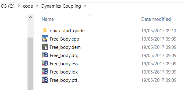

Place the
.cppfiles that you have written in a working directory.For example,C:\code\Dynamics_Coupling. In this instance, aFree_Body.cppfile is used which can be found on the EDEM forum. -

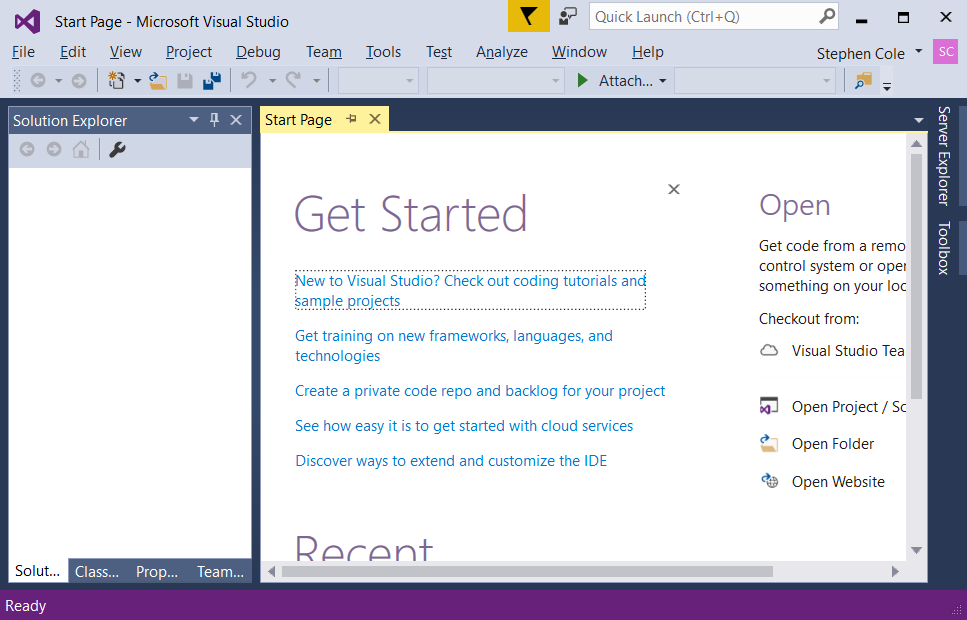

Start Visual Studio.

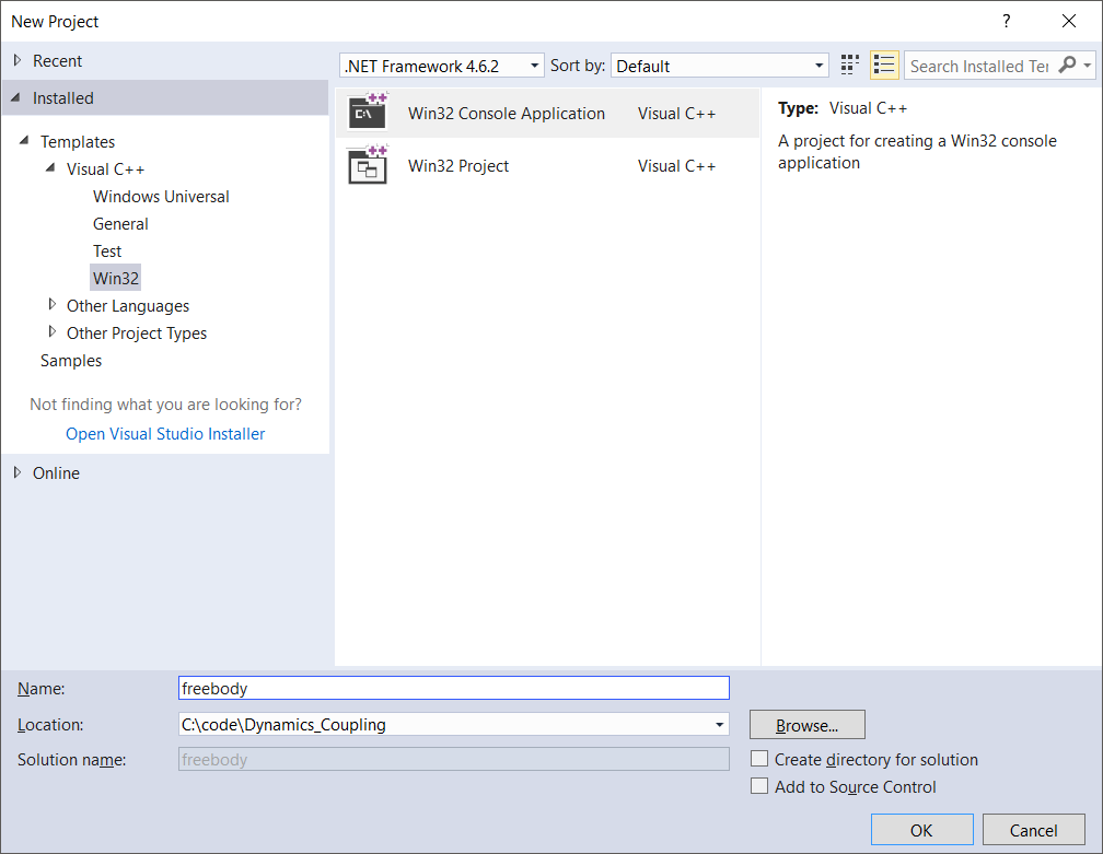

To create a new project (Win32 Console Application Visual C++), go to .
Set
Set the location to:
C:\code\Dynamics Couplingand then click OK. -

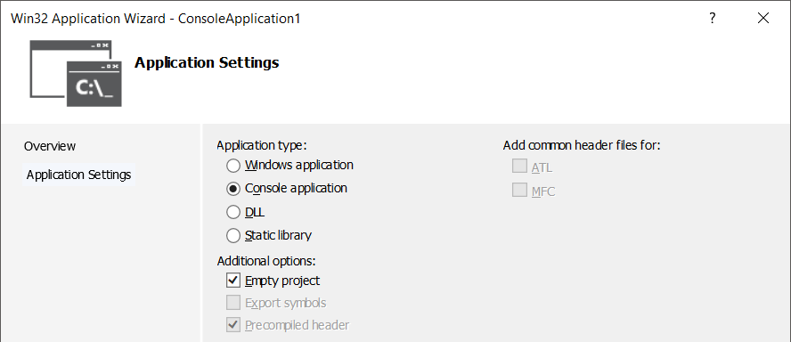

Select Application Settings and then do the
following:
- Select Console Application.
- Select Empty Project.
- Click Finish.

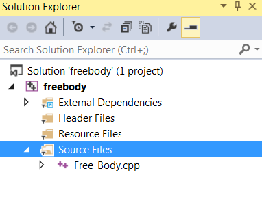

Add the file
Free_Body.cppto the project.- Copy this file to the following location:
C:\code\Dynamics_Coupling\freebody. - Right-click .

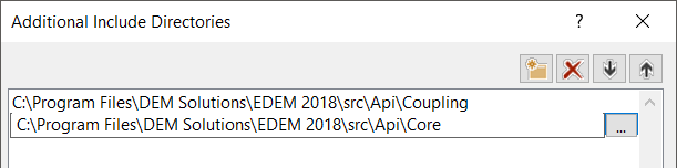

- Select Additional Include Directories and
then click Edit.
- Add the following paths then click
OK.
C:\Program Files\Altair\<version number>\EDEM\bin\src\Api\CouplingC:\Program Files\Altair\<version number>\EDEM\bin\src\Api\Core

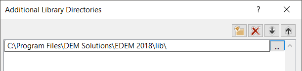

Select .
- Include the following:
C:\Program Files\Altair\<version number>\EDEM\lib\
Select .
- Add
EDEMCouplingClient4.lib.
- Click OK.
