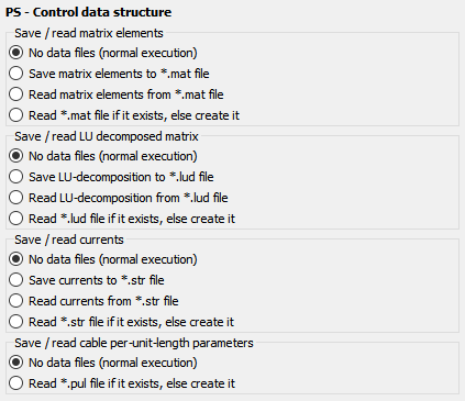

PS Card
This card is for general program control such as storing the currents for re-use in a subsequent version of the model in order to save runtime.
On the Request tab, in the Output control
group, click the
Data structures
(PS) icon.
This card can also be used to save the cable per-unit-length parameters between frequency runs to prevent the parameter recalculation for every frequency.
Parameters:
- Save / read matrix elements
- Select this option to save or read the matrix elements of the system of linear equations. This is typically not recommended, since the file will be large and the time to recompute the matrix elements is typically much shorter than the time for the LU-decomposition of the matrix.
- Save / read LU decomposed matrix
- Select this option to save or read the LU-decomposition of the system of linear equations. This option is useful if you want to solve a problem repeatedly with multiple different excitations (right-hand sides). Note that if you do this in one Feko run (that is one .pre file), then Feko keeps the LU-decomposition automatically in memory.
- Save / read currents
- Select this option to save or read the solution vector of the system of linear equations. The solution vector corresponds to the currents on the structure being simulated.
- Save / read cable per-unit-length parameters
- Select this option to save or read the cable per-unit-length parameters.
Feko always uses the most efficient computation when doing multiple solutions in one file. However, sometimes one might also do a solution, look at the results and then change certain parameters. Then the option to store the solution in the .str file and load it again or the similar option for the LU-decomposition are particularly useful. The option to save the currents is applicable when the solution remains unchanged (such as the geometry, material parameters, loads, frequency and sources), but when one wants to compute the near- or far fields with different options. The storage of the LU-decomposition is useful when only the right-hand side of the system of linear equations changes (for example the direction of incidence of a plane wave). Feko has built-in checks and reports a warning if, for example, currents were exported for one frequency and are later imported again for another frequency.
