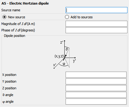

On the Source/Load tab, in the Ideal sources group, click the  Electric dipole (A5) icon.
Figure 1. The A5 - Electric Hertzian dipole dialog.
Parameters:
New source
A new excitation is defined which replaces all previously defined excitations.
Add to sources
A new excitation is defined which is added to the previously defined excitations.
Magnitude of I dl (A m)
Absolute value of the complex amplitude I⋅l in Am.
Phase of I dl (degrees)
Phase of the complex amplitude I⋅l in degrees.
X, Y, Z position
Coordinates of the position of the dipole in m. These values are optionally scaled by the SF card.
ϑ angle
Orientation of the dipole in space. The angle ϑ (in degrees) is the angle between the dipole and the Z axis.
φ angle
Orientation of the dipole in space. The angle φ (in degrees) is the angle between the projection of the dipole onto the Z=0 and the X axis.
