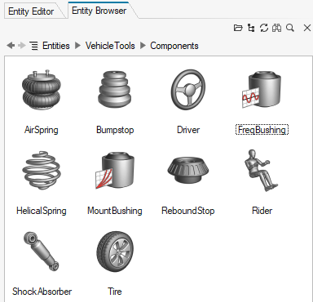

    1. The Entity Browser contains the Vehicle Tools library:
      • Vehicle Tools Components are displayed below. These components can be included in any MotionView model.
        Figure 4. Vehicle Components Available in the Entity Browser

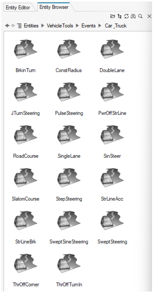

      • Vehicle Tools Events allow you to add vehicle analysis Cars, Trucks, Motorcycles and Tires test rigs. The figure below shows the vehicle events available for full vehicle models from the Car & Small Truck library.
        Figure 5. Car & Truck Events

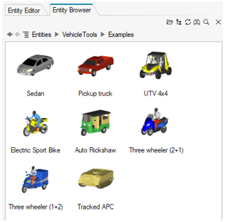

      • Vehicle Tools Examples are available to demonstrate the main MotionView tools. As shown in the figure below, a collection of different full vehicles models can be added in MotionView.
        Figure 6. Vehicle Model Examples

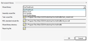

  1. From the Vehicle Tools ribbon, click on the Libraries tool to invoke the Set wizard library dialog.
    Figure 7. Setting Wizard Library of Preference
  2. Click on the Wizard library drop-down menu to reveal the following options:
    • Car/Small truck
    • Heavy truck
    • Two-wheeler
    • User/Custom library

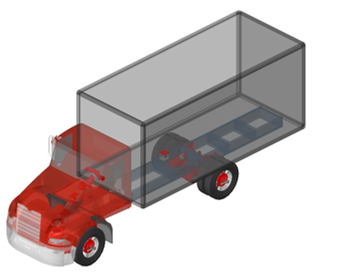

    Heavy truck
    The following models are eligible for creation through the Heavy truck library:
    1. Front end of truck
      Figure 13.
    2. Rear end of truck
      Figure 14.
    3. Full truck with driver
      Figure 15.

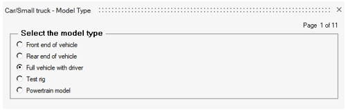

  3. In the same group, click on Assembly to invoke the selection wizard.
  4. Select Full vehicle with driver from the wizard and select Next.
    Figure 18. Select the Model Type

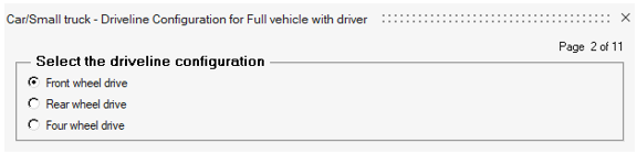

  5. Click on the Front Wheel Drive option for the driveline configuration and select Next to access the Primary Systems page.
    Figure 19. Select Driveline Configuration

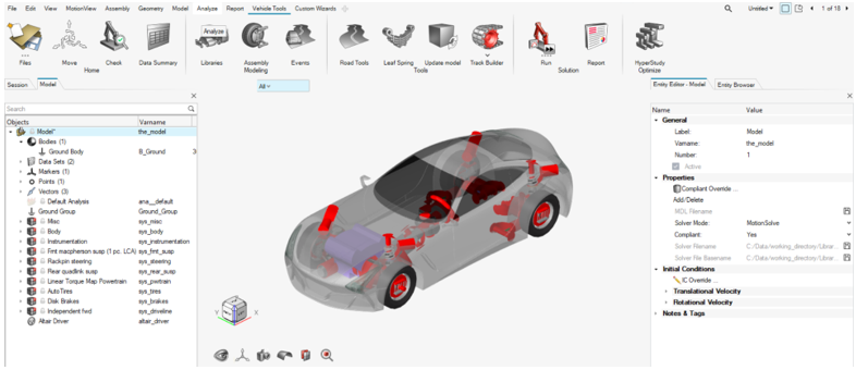

  9. In the last page of the wizard, the option for the Driver System comes as a prerequisite in every vehicle model’s creation. The Altair Driver is responsible for the control of throttle, brake and steering inputs according to the requested outputs.

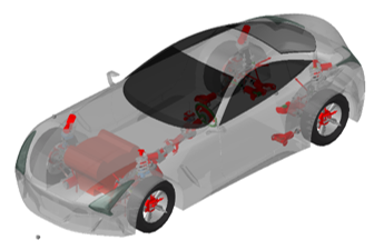

  10. Finally, click Finish to complete setting up your model. A full vehicle model with driver now appears in your modeling window, as shown in the figure below.
    Figure 21. Full Vehicle Model with Driver in MotionView

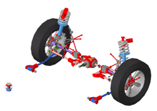

The model is configured in such a way that you can change any parameter in the vehicle. Starting with hardpoint locations to modify the suspension kinematics that can be done by simply editing the pair point locations. You can also modify the spring/dampers and bushings properties, mass and inertia of the suspension components, kinematic parameters such as initial Toe, Caster, and Camber, Tire files, and input any other external data used to define the vehicle model.
  1. From the Body system, you can alter vehicle body’s graphics, properties (such as mass), inertias and shift its center of gravity.
  2. From the Front and Rear suspension systems, you are able to modify suspension components’ properties and geometry, by changing their inertial properties and the chassis hardpoints. Additionally, you can change the spring-damper stiffness and damping properties, or even import your own suspension components to replace the existing ones.

  1. From the Vehicle Tools ribbon, click on Events to open the Entity Browser folder of Events.
  2. From the Entity Browser, double-click on Double Lane to add the event in the model.
    Figure 22. Entity Browser - Double Lane Event

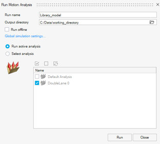

  2. From Vehicle Tools ribbon, click on the Analysis settings icon on the Run ribbon.
  3. In the Run Motion Analysis window:
    1. Specify Run name as Library_model.
    2. Specify an Output directory such as your <working directory>, where the results files will be saved.
      Figure 24. Run Motion Analysis Window
    3. Click Run.

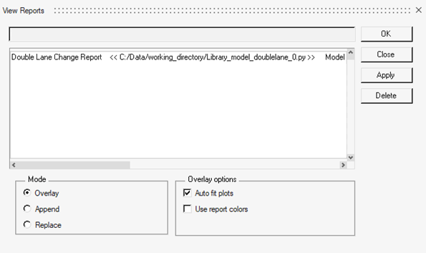

  1. From the Vehicle Tools ribbon, click on the Report tool , in the Solution group.
  2. In the View Reports dialog, select the newly generated report and click OK.
    Figure 25. View Reports Dialog
    Note: After generating the report, several new pages containing useful information on the simulation results are added to the session. From here, you can review the vehicle’s overall performance regarding the suspension, traction and engine capabilities while considering accelerations and driver inputs.

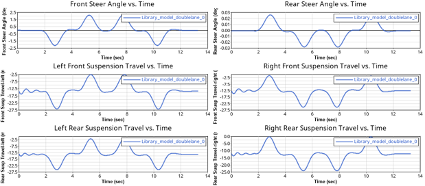

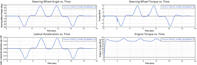

  4. Finally, browse the next pages to view the plots automatically generated by the report.
    Figure 26. Vehicle’s Lateral Acceleration, Steering Wheel Inputs and Engine Torque
    Figure 27. Suspension Travel Results
    Figure 28. Tire Lateral Slip Results
