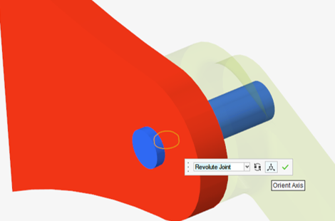

    5. Click the Create button on the microdialog to create a joint with the selected body and point references.
      Note: The microdialog now appears with additional options like Joint Type, Swap Bodies, and Finish Editing.
    6. Change the Joint type to Revolute from default Ball.
      Note: Observe that a new option Orient Axis (applicable to this joint type) appears on the Guide Bar.
      Figure 18. Changing Joint Type using the microdialog
    7. Click Orient Axis button on the microdialog to enter the Orientation Context to orient the revolute joint axis.
      A vector tool appears that can be used to define the orientation of the revolute joint.
      Figure 19. Vector Tool Available in the Orientation Context
    8. Grab the Z Axis handle of the Vector Tool (by holding down the left mouse button).
    9. Drag around to find Global X axis direction.
      Note: As the handle is dragged around, notice that it highlights points/vectors while hovering over CAD geometry as well as Global Axes while hovering in the empty space.
      Figure 20. Global Axes Available for Joint’s Orientation
    10. Move closer to Global X label and notice that it gets highlighted with an underline (Global X). Release the mouse to select it.
      Tip: When selecting Global axes, release the mouse outside of any CAD geometry.
      The Z axis of joint should now be aligned along the Global X direction.
      Use the right-click Exit Context button to exit the orientation and return to the Joint context.
    11. Click the Finish Editing check mark button on the Joint’s Microdialog to complete defining the current joint.
