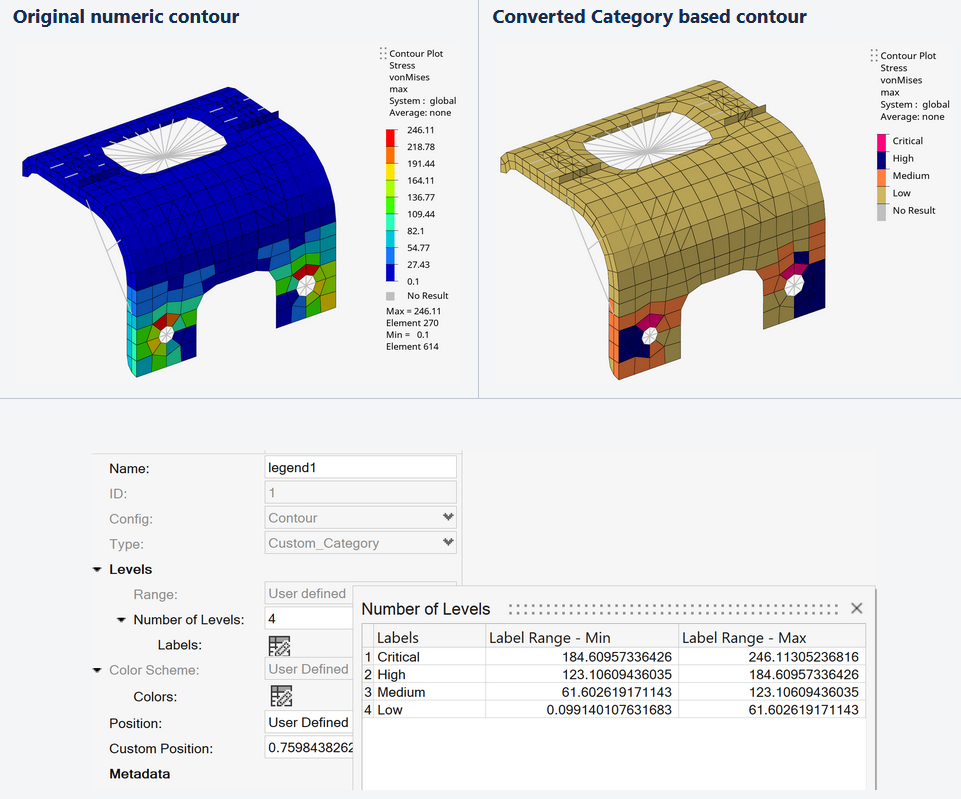

Figure 36. - Custom Category-based Legends
 - A new type of category-based legend is supported. You can convert any
                            numeric result into categories and visualize it as a discrete,
                            range-based contour plot. For example, you can visualize a stress
                            contour plot as four categories by defining a custom category legend and
                            assigning it to the plot control.
Figure 37.
