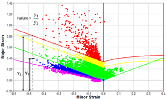

 - Failure contour (%) - Creates a failure contour
                        based on the relative distance of an element in FLC from line (Y1/Y2)*100.
                        See the figure below. Its value will be between 0-100 for points below the
                        failure line and above 100 for points above the failure line.
