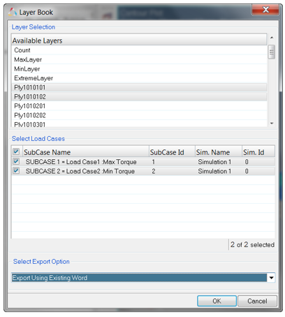

Layer Selection
Select which layer you want to extract information from.Select Load Cases
Select from the list of available load cases.Select Export Option

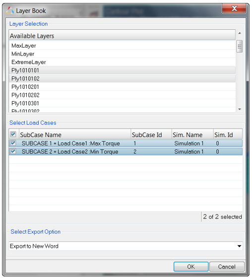

- Export to New Word
 - Select the combination from the graphical user interface and a new Word Document
              will be generated with a new chapter for each load case, each one having as many
              sub-chapters as the number of selected layers.For example, the following combination (2 layers – 2 load cases) will generate a document with two chapters and two sub-chapters:

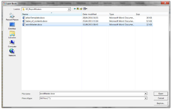

Figure 2. - Export Using Existing Word
 - This approach is similar to the previous one, however you will be asked, after the
              selection, to point to an existing document or template. The organization of the
              chapters is the same as the previous use case, however the headings will be taken from
              the document set up.For example, the following option selections:

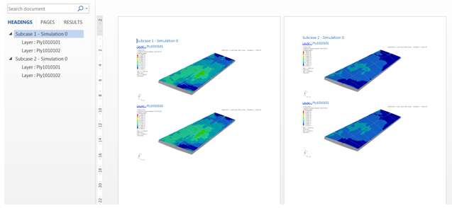

Figure 3.With:
Figure 4.Results in:
