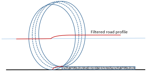

Elliptical Cam Contact Model
- Effective road height variation
 - Effective slope variation
 - Effective curvature
 - Camber change
Figure 3. 3D Elliptical Cam Contact Arrangement
Figure 4. Vertical force at constant axle height when tire is rolled over a cleat (10 mm height, 50 mm length) at constant velocity of 10.833 m/sec (39km/h)
Figure 5. Longitudinal force at constant axle height when tire is rolled over a cleat (10 mm height, 50 mm length) at constant velocity of 10.833 m/sec (39km/h)
The results show that single point contact model predicts higher values of vertical force because it traces the obstacle, however the actual force experienced by the tire is less which is closely predicated using cam contact method.
Figure 6. Filtered Road Profile Using a Series of Cams

The equation for the shape of cam can be written as:
Figure 7. Cam Dimension
Figure 8. Cam with Two Point Follower
