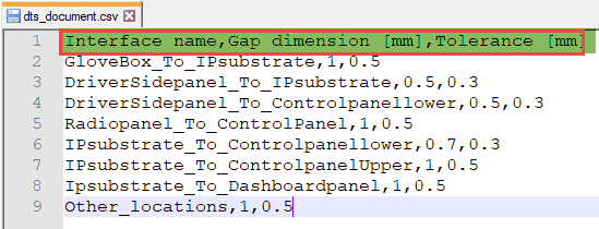

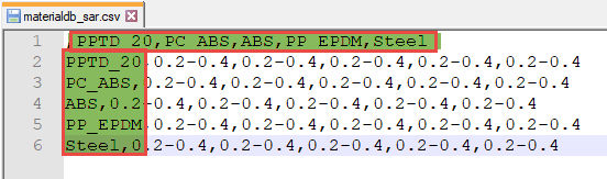

You can import a DTS file containing predefined gap and tolerance values for all the interfaces to evaluate and a material database file with compatibility data from Stick-Slip tests. If a material database file is unavailable, you can connect to Ziegler Material Database. For more information, see Ziegler PEM Material Database.

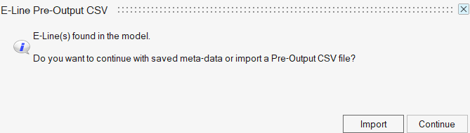

- If a model contains existing E-Line(s), you have an option to
restore E-Lines information from a pre-output
CSV file or from the data stored in the file itself.
The latter option is only available for .hm files. Restriction: Existing E-Lines in a Solver Deck can not be restored without a pre-output CSV file, which can only be created at Export. Save the progress in the .hm file.

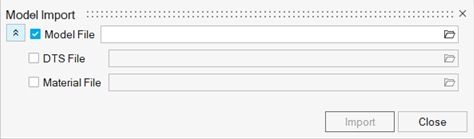

Import Options
Learn more about the available import options.
- Model File
- The user-defined DTS data is imported, and you can map an interface name to the corresponding E-Line using the Manage E-Line tool.
- DTS File
- The user-defined Material database is imported, and you can map material to corresponding squeak lines in the Manage E-Line tool.
- Material File
- A Material file is a
*.csvfile containing the user-created material stick-slip data.
to specify DTS and material files.
