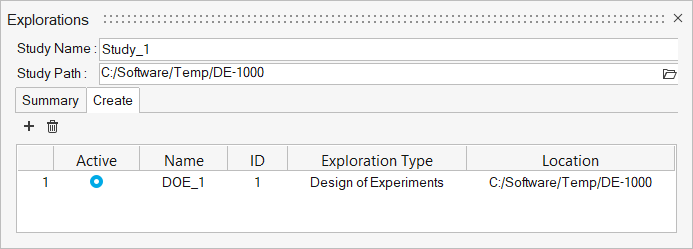

Figure 2.The Explorations dialog opens. -
Click
then select DOE.
In the Study Path field, browse to and select the folder to store your
DOE.

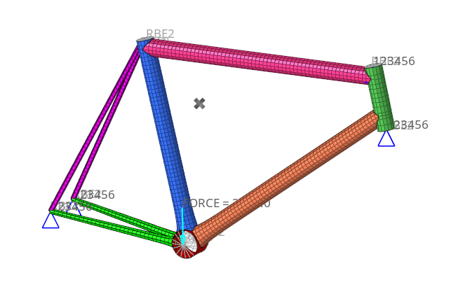

Figure 5. - In the modeling window, select the blue seat_tube property and the orange down_tube property.
In the microdialog, click
Create.
Two gauge design variables are created.
Figure 6.

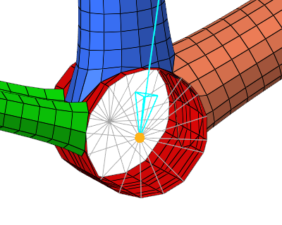

In the modeling window, select the node where the crank
load is applied.
Figure 9. -
An Entity Editor window appears.- Change the response name to Crank.

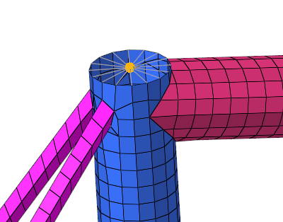

Select the node where the seat sits.
Figure 10.A second displacement response is created. -
An Entity Editor window appears.- Change the response name to Seat.
- From the Response Component drop-down menu, select MAG.
- Click Close.

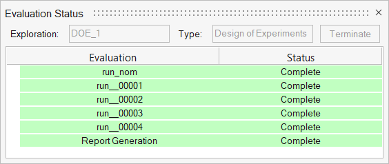

The DOE is evaluated. In this case, there will be a nominal run plus four DOE runs.
This may take a few minutes depending on your computer.
When the evaluation is complete, the Evaluation Status dialog should look like Figure 13.
Figure 13.

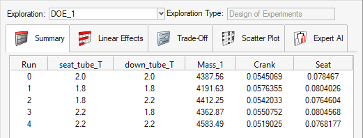

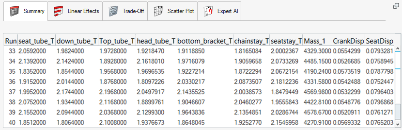

Figure 14.The Results Explorer browser opens. -
Review the Summary table, which shows the input and response values for each
run of the DOE.
Figure 15. -

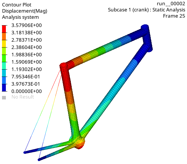

Right-click on any row in the Summary table and select Load
Results.
A HyperView window opens, and the results contour from the selected run is displayed.
Figure 16. -

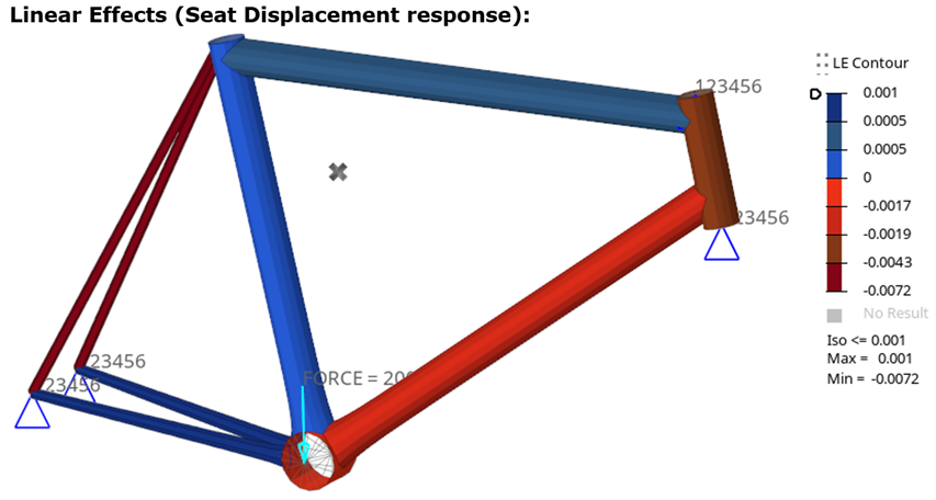

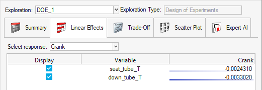

In the Results Explorer, click
Linear Effects.
From the Select response drop-down menu, select
Crank.

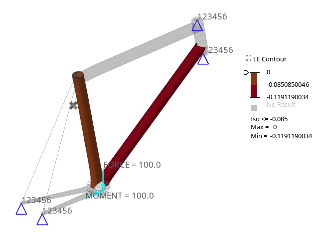

The Linear Effects plot shows the relative contribution of each design variable on the crank displacement response.
Figure 17.Note: Notice the negative correlation between the gauge design variables and the displacement response. This indicates that an increase in the gauge of the component will result in a corresponding decrease to the displacement response. In addition, the relative effect of a change to the down tube thickness will be greater than a similar change to the seat tube thickness.In addition, the effects contour is mapped onto the model itself in the graphics area for visualization.
Figure 18.Note: This can be quite useful when dealing with a larger number of design variables.In the table as well as on the model, positive effects – indicating a positive relationship between the design variable and response – are shown in shades of blue, whereas negative effects – indicating an inverse relationship between the design variable and response – are shown in shades of brown.

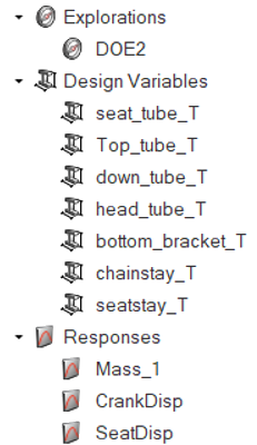

As an exercise, try creating a similar DOE where the gauge of every component
is a design variable. Your DOE and reports should look something like the
following (your actual values will vary, based on your specific design variable
bounds choices).
Figure 19.
Figure 20.
Figure 21.
