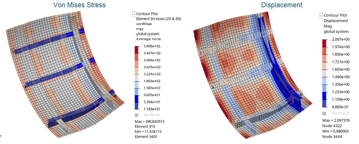

  6. From the Post ribbon, select the Contour tool.
  7. In the Contour dialog, enter Element Stresses for Name.
  8. For Data Type, select Element Stresses (2D & 3D).
  9. For Data Component, verify vonMises is selected.
  10. From the guide bar, click Plot.
  11. From the Post ribbon, select the Create Contour tool from the Contour tool group.
    Figure 3.
  12. In the Contour dialog, enter Displacements for Name.
  13. For Data Type, select Displacement.
  14. For Data Component, select Mag.
  15. From the guide bar, click Plot.
    Figure 4.

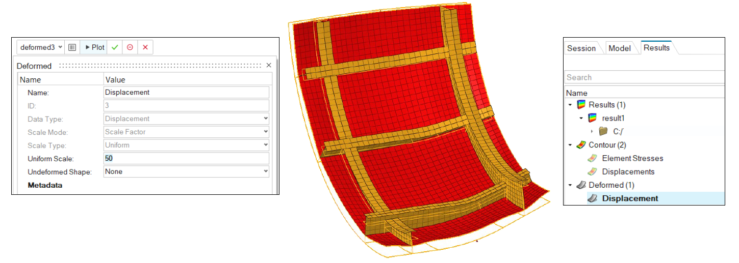

  16. From the Post ribbon, select the Deformed tool.
    Figure 5.
  17. In the Deformed dialog, enter Displacement for Name.
  18. For Data Type, verify Displacement is selected.
  19. Optional: Define the Uniform Scale.
  20. From the guide bar, click Plot.
    Figure 6.

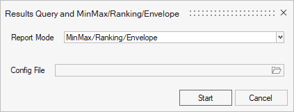

  1. From the Post ribbon, select the Tools tool.
    Figure 7.
  2. In the Results Query and MinMax/Ranking/Envelope dialog, select MinMax/Ranking/Envelope for Report Mode and click Start.
    Figure 8.

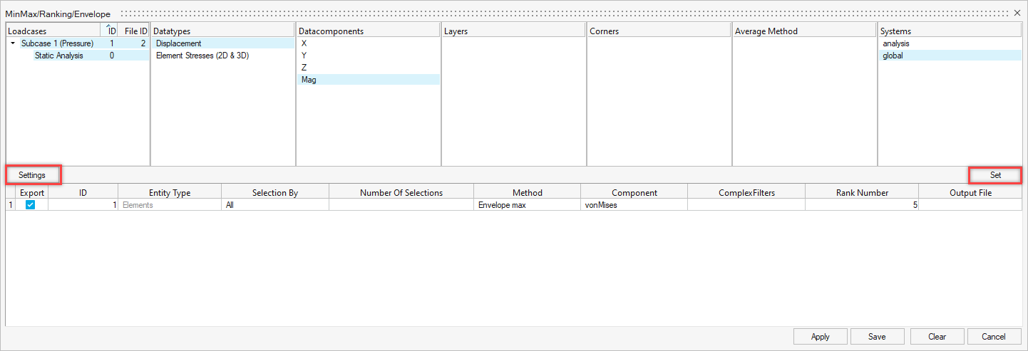

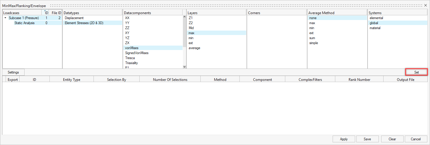

  3. In the MinMax/Ranking/Envelope dialog, select Static Analysis and Element Stress (2D & 3D).
  4. Set the other parameters to match Figure 9 and click Set.
    Figure 9.
  5. For Datatypes, select Displacement.
  6. Set the other parameters to match and click Set.
    Figure 10.
  7. Optional: Click Settings to edit the export settings of the results.

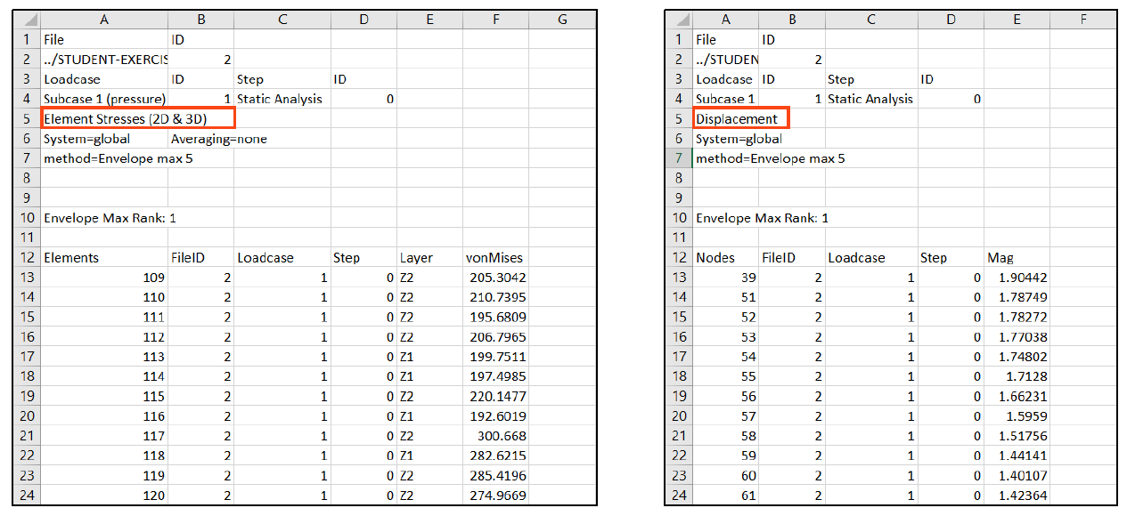

  11. Open the exported .csv files and review the queried results.
    Figure 11.
