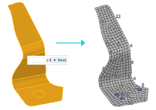

From the 2D ribbon, select the General 2D Mesh > Create tool.
Figure 3. - In the modeling window, select all displayed surfaces.
From the guide bar, click
For Element size, enter 2.5.
Figure 4. - From the guide bar, click Mesh.

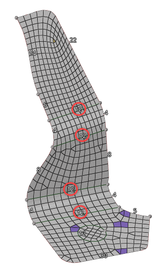

If necessary, select the General 2D Mesh > Density tool from the 2D ribbon.
Figure 5. -
Set the density of the edges shown in Figure 6 to 12.
- Hover over an edge with a density of 12 and press Ctrl > C to copy its settings.
- Hover over an edge you wish to change and press Ctrl > V to paste the settings.
- If necessary, select Update from the guide bar.

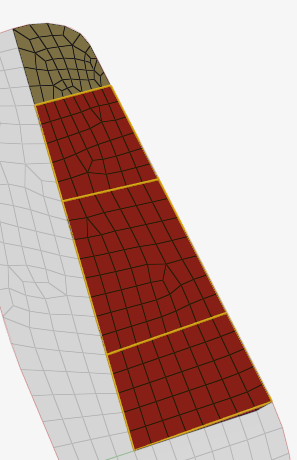

Select the General 2D Mesh > Edit Faces tool from the 2D ribbon.
Figure 7. -
In the modeling window, select the two surfaces
highlighted in Figure 8.
Figure 8. - In the microdialog, set Element type to Quads only.
- Select the Map Type tab, and verify Map as is set to Rectangle.

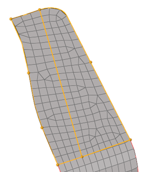

From the Topology ribbon, select the Split > Interactive tool.
Figure 9. -
Left-click and drag to create a line to split the surface.

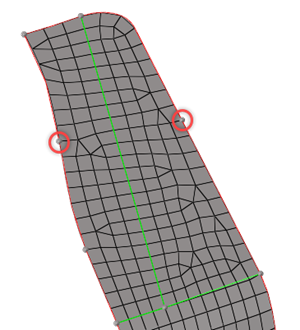

Figure 10. -
Left-click to create two fixed points.
Figure 11. -

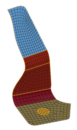

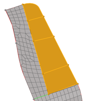

Figure 12. -
In the modeling window, select the two surfaces and
click Mesh from the guide bar or
microdialog.

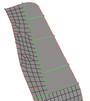

Figure 17. -
Left-click and drag to create lines to split the surface as shown in Figure 18.
Figure 18. -

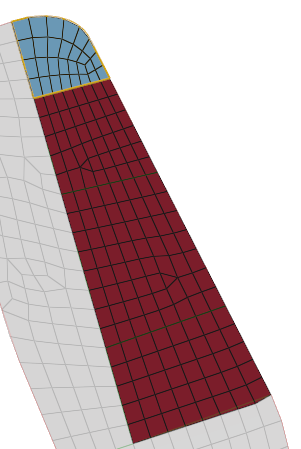

Figure 19. -
In the modeling window, select the four surfaces and
microdialog.
Figure 20. -

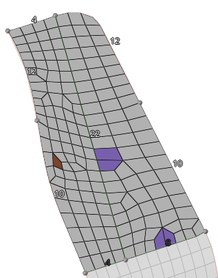

Figure 21. -
Set the edges density as shown in Figure 22.
Figure 22.Note: Your edge density may be slightly different. Adjust the edge density to obtain a regular mesh as shown in the images. -

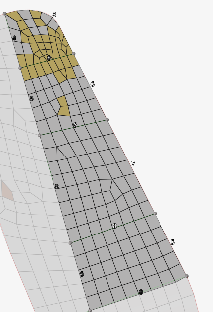

Figure 23. -
In the modeling window, select the surfaces highlighted
in Figure 24.
Figure 24. - In the microdialog, verify Element type is set to Quads only.
In the modeling window, select the surface shown in
Figure 25.
Figure 25. - In the microdialog, verify Element type is set to Quads only.
- Select the Map Type tab, and set Map as to Triangle.
