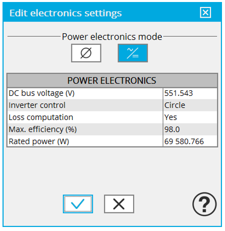

1 Button to not consider power electronics stage (=default mode)
2 Button to define the user parameters of the power electronic mode

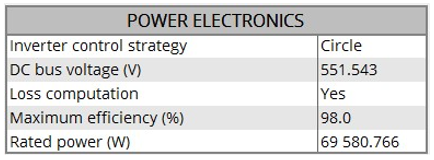

The whole list of power electronics parameters is illustrated below.
Power electronics mode: whole list of input parameters

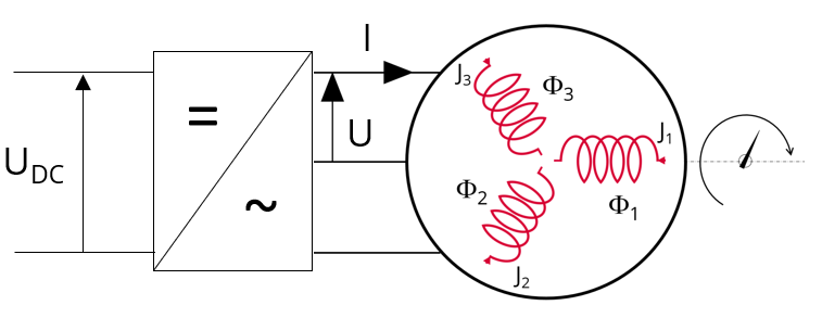

Voltage and current inputs of the power electronics stage and electrical machine
The chosen inverter control drives the ratio between the DC bus voltage and the line-line voltage seen at the machine terminal. This ratio is defined as:
Where U DC is the DC bus voltage before inverter stage and U rms is the rms value of the first harmonic of the line-line voltage at the terminal end of the machine.

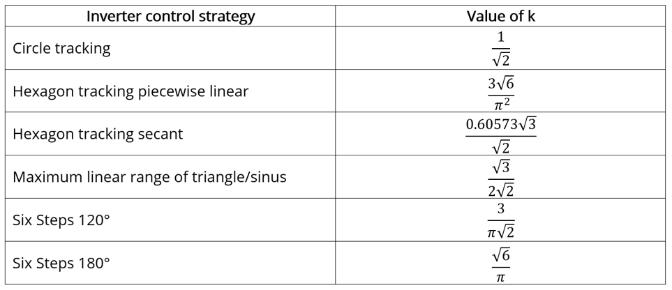

The considered inverter control strategies and their corresponding values of k are listed in the table below.

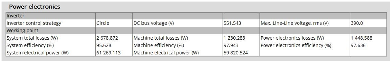

4. Dedicated outputs
When power electronics is active, the line-line voltage at the machine terminals and the DC bus voltage are computed/displayed.
Moreover, when the “loss computation” is selected by the user, additional output data are computed and/or displayed.
The losses and the efficiency are computed for the machine, the power electronics stage and the system. The “system” gathers the machine and the power electronics stage.
Then, the electrical power is computed for both the machine and the system.
Power electronics mode with loss evaluation – Example of dedicated output table

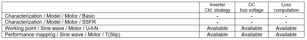

5. Power electronic and tests
The available input parameters dedicated to the power electronics mode depend on the considered test.
Below is the table in which are defined the correspondence between the tests and the input parameters of the power electronics mode.
The whole list of input parameters is illustrated below.
Whole list of input parameters dedicated to power electronics
