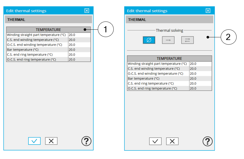

2. Without thermal solving mode
The first option of thermal setting is to run the test with only electromagnetic computation without any thermal analysis.
This option is the default one available for all the tests.
In this case, one must define the temperatures of active components to make the corresponding material physical properties updated.
For Induction Machines with Squirrel cage, stator winding and squirrel cage temperatures must be defined.

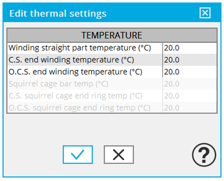

2.1 Temperature of winding
Settings of winding temperature

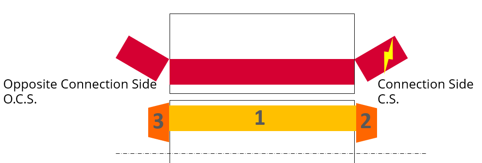

It is possible to define temperature of the three main parts of the stator winding:
  • Winding active length temperature (part 1)
  • Connection Side (C.S.) end winding temperature (part 2)
  • Opposite Connection Side (O.C.S.) end winding temperature (part 3)
Definition of the main parts of winding
The resulting resistance of each part of the winding is updated according to the temperature:
  • Winding straight part resistance (part 1)
  • Connection Side (C.S.) end winding resistance (part 2)
  • Opposite Connection Side (O.C.S.) end winding resistance (part 3)
The resulting resistance for the whole winding (considering the three parts described above) is computed as phase resistance and line-line resistance.

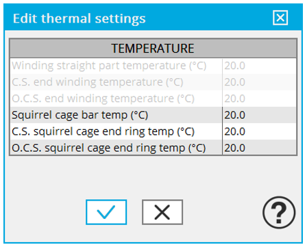

2.2 Temperature of the squirrel cage
Setting of the squirrel cage temperature

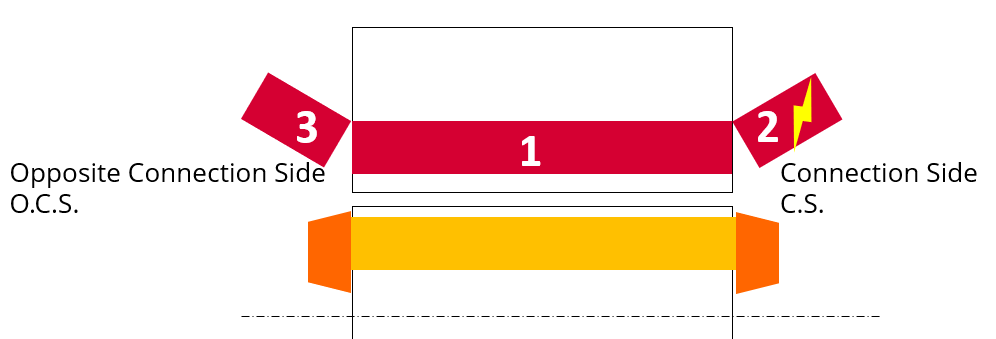

It is possible to define temperature of the three main parts of the squirrel cage:
  • Bar temperature (part 1)
  • Connection Side (C.S.) end ring temperature (part 2)
  • Opposite Connection Side (O.C.S.) end ring temperature (part 3)
The resulting resistivity and resistance of each part of the squirrel cage is updated according to the temperature:
  • Bar DC resistance (part 1)
  • Connection Side (C.S.) end ring resistance (part 2)
  • Opposite Connection Side (O.C.S.) end ring resistance (part 3)

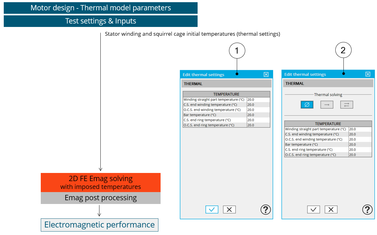

2.3 Flow chart of the tests without thermal solving mode
Below is the flow chart of computation, for test without thermal solving mode, available for all the tests.
1 Default mode of thermal setting for all the tests without thermal analysis
2 Thermal settings for the tests which have a thermal analysis are available

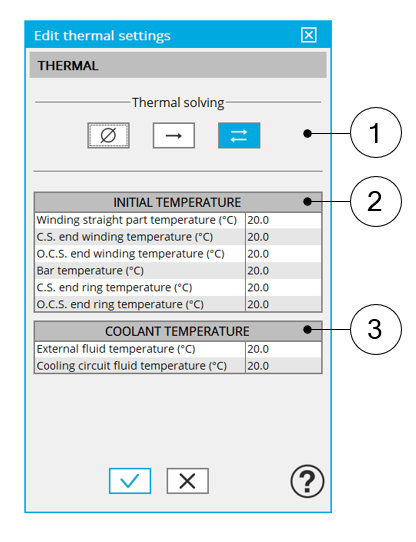

3.2. Thermal settings to initialize the test
For both scenarios, here is the list of thermal settings needed to initialize the test.
1 Dialog box to define thermal setting. Iterative solving mode is selecting
2 Initial temperatures of the machine active components: Stator winding and squirrel cage.These temperatures are used to initialize the electromagnetic-thermal process of computation.
3 Definition of coolant temperatures to be considered:
  • External fluid temperature (1)
  • Cooling circuit fluid temperature (2)
Note:
  1. The external fluid temperature corresponds to the temperature of the fluid surrounding the machine. It is also considered as the temperature at the “infinite” for the computation of radiation from the frame to the infinite.
  2. The cooling circuit fluid inlet temperature is proposed only when a cooling circuit has been added by the user in the design environment.

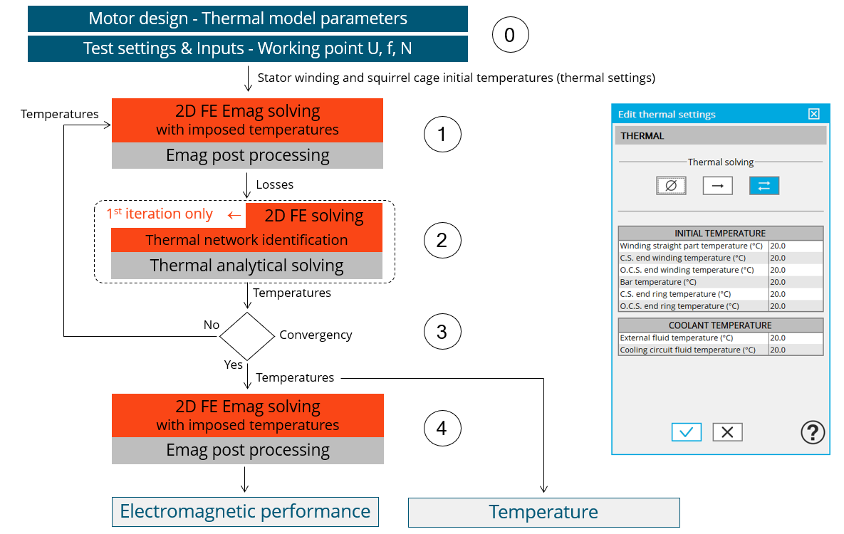

3.3 Flow chart of thermal solving mode – “Iterative” process
3.3.1 Flow chart of the thermal solving mode test with iterative process
0 Definition of the initial temperatures (see the list in the previous section) and working point inputs
1 1 st electromagnetic solving (Finite Element computation) with initial temperature defined in the thermal settingsLosses are computed.
2 Based on losses and speed defined by the electromagnetic working point, the thermal characterization is performed to define the temperature distribution inside the machine.The materials physical properties corresponding to the machine active components are then updated
3 Iterative process = loop between electromagnetic and thermal computations until the convergence on the temperature is reached (See below where can be adjusted the convergency criteria when needed)
4 A last electromagnetic solving (Finite Element computation) with final set of temperatures is performed once the convergence on the temperature is reached (1) .
Electromagnetic performance and chart of temperatures are computed and displayed.The test outputs are illustrated in the sections dedicated to the considered tests.

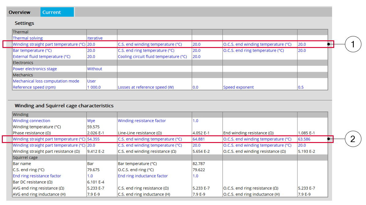

(1) The temperatures which are considered for computing the final machine performance (step 4 in the previous flow chart) can be read in the table dealing with “Winding and Squirrel cage characteristics” of the test configuration at the beginning of result report.
See below illustration.
The temperatures are also displayed in the chart of temperature and table after the electromagnetic results.
1 Initial winding temperatures
2 Resulting final temperatures which are considered for computing resulting machine performance

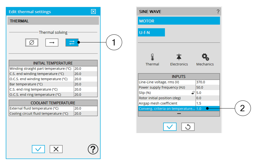

3.4 Iterative process – Adjustment of the convergence criteria
1 Selection of the thermal solving Iterative process in thermal settings
2 Convergence criteria can be adjusted for reaching steady state behavior.
The iterative solving is stopped once the temperature variation in the machine between two iterations is lower than the convergence criteria. A percentage close to zero gives more accurate results but takes a higher computation time. A high percentage can make the convergence shorter but decreases the accuracy of the results.

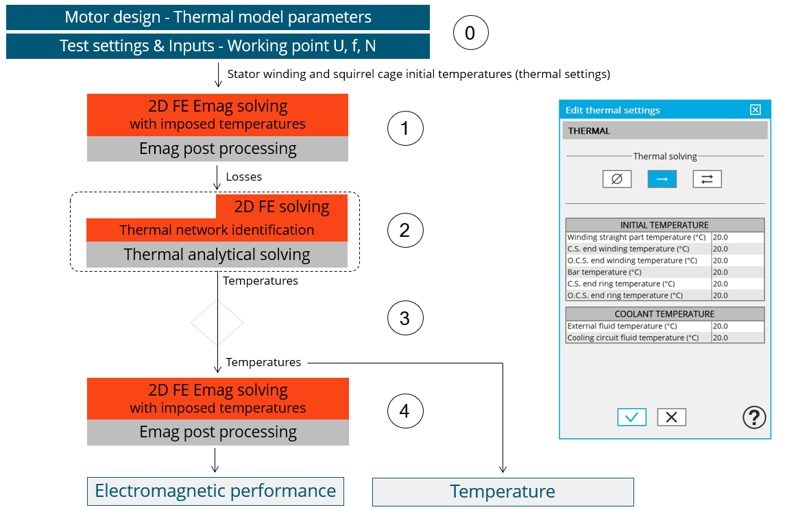

4. Flow chart of thermal solving mode – “One iteration” process
4.1 Flow chart of the thermal solving mode test with one iteration.
2 Based on losses and speed defined by the electromagnetic working point,The thermal characterization is performed to define the temperature distribution inside the machine (1) .The materials physical properties corresponding to the machine active components are then updated.
3 There is not iterative process = only one iteration is carried out.
4 A last electromagnetic solving (Finite Element computation) with final set of temperatures got after convergence is performed (2) .Electromagnetic performance and chart of temperatures are computed and displayed.
  1. It corresponds to what is performed to make the thermal characterization of the machine in the test Characterization / Thermal / Steady state

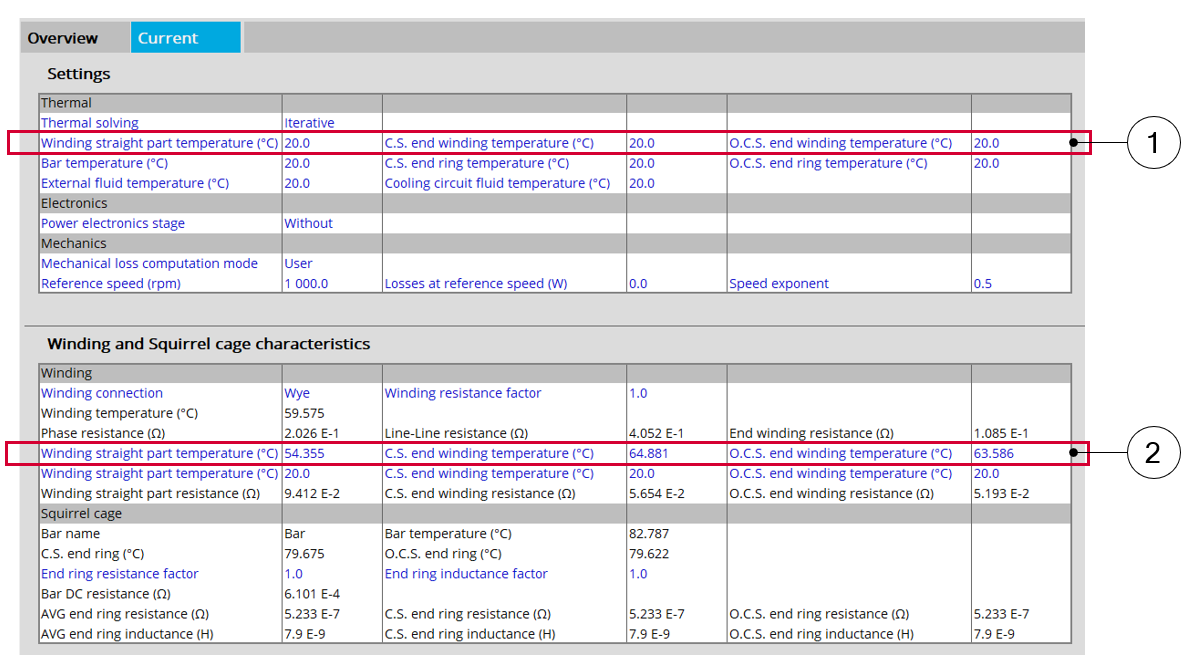

  2. The temperatures which are considered for computing the final machine performance (step 4 in the previous flow chart) can be read in the table dealing with “Winding and Squirrel cage characteristics” of the test configuration at the beginning of result report. See below illustration.
