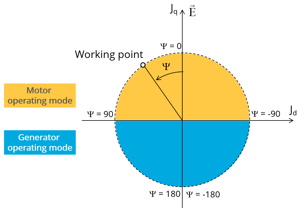

  2. Control angle
    Considering the vector diagram shown below, the “ Control angle ” is the angle between the electromotive force E and the electrical current (J) (Ψ = (E, J)). It is an electrical angle. It must be set in a range of -90 to 90 degrees.
    This range of values covers all the possible working point in motor convention.
    Definition of the control angle Ψ - Motor convention

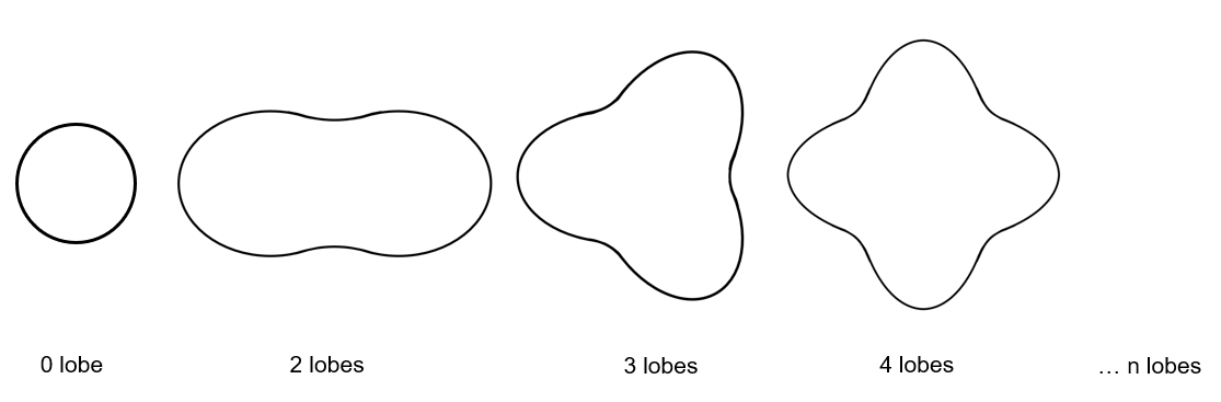

The “ max. mode / spatial order ” ( Maximum mode / spatial order ) input allows the user to define the number of modes to be considered for the acoustic structural analysis. If the user selects 25, it means that the highest number of lobes in the stator deformation will be equal to 25 lobes. All deformations corresponding to more than 25 lobes will be dismissed.
Number of lobes of the stator mechanical structure
