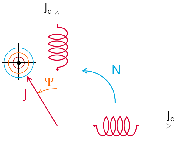

The aim of the test “Mechanics – NVH – Spectrogram – I-Ψ-N” is to perform NVH analysis on the machine when operating at a set of targeted working points defined with the following inputs values I,Ψ,N (Magnitude of current, Control angle, Speed).
“Working point – Sine wave – Motor – I, Ψ, N ” illustration
