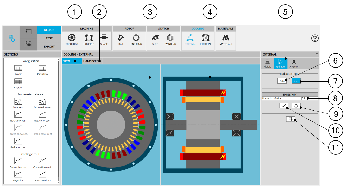

External cooling - Radiation design area |
1 |
Display the axial and radial view of the machine. |
2 |
Display the external cooling datasheet, showing the main thermal
parameters of the frame cooling. |
3 |
Radial view of the motor, where specific exchange areas can be
highlighted depending of the selected input. |
4 |
Axial view of the motor, where specific exchange areas can be
5 |
The section radiation is selected. |
6 |
Button to set the external emissivity of the frame by automatic
process. |
7 |
Selected button, to set the external emissivity of the frame
manually |
8 |
Input related to the radiation corresponding to the selected
radiation mode. In user mode, only the Frame to infinite emissivity
must be define. The default value is 0.8. |
9 |
Button to restore default input values. |
10 |
Button to apply inputs. Pressing the enter key twice applies
inputs too. |
11 |
Icon to export external cooling data into *.txt or *.xls
files.. |
