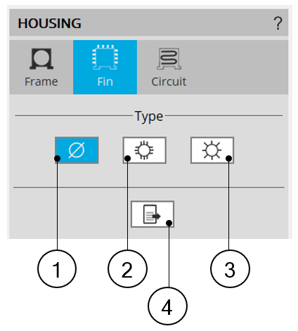

1 |
Default setting : Fin type is « None » The housing has no fin. |
2 | Button to select parallel type fins. | |
3 | Button to select radial type fins. | |
4 | Icon to export fin data into *.txt or *.xls files. | |

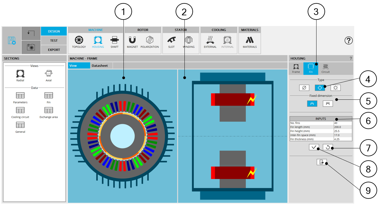

Parallel type fin design area | |
1 | Radial view of the motor, including the housing topology with fin topology and dimensions. |
2 | Axial view of the motor, including the housing topology with fin topology and dimensions. |
3 | The section fin is selected to define the type and dimensions of the fins. |
4 | Selected button to define parallel type fins. |
5 | Two ways are possible to define the fin dimensions: "Height" and "Extension" options. See below illustrations. |
6 | User input parameters to define the fin dimensions. For more information see below. |
7 | Button to restore default input values. |
8 | Button to apply inputs. Pressing the enter key twice applies inputs too. |
9 | Icon to export frame data into *.txt or *.xls files. |

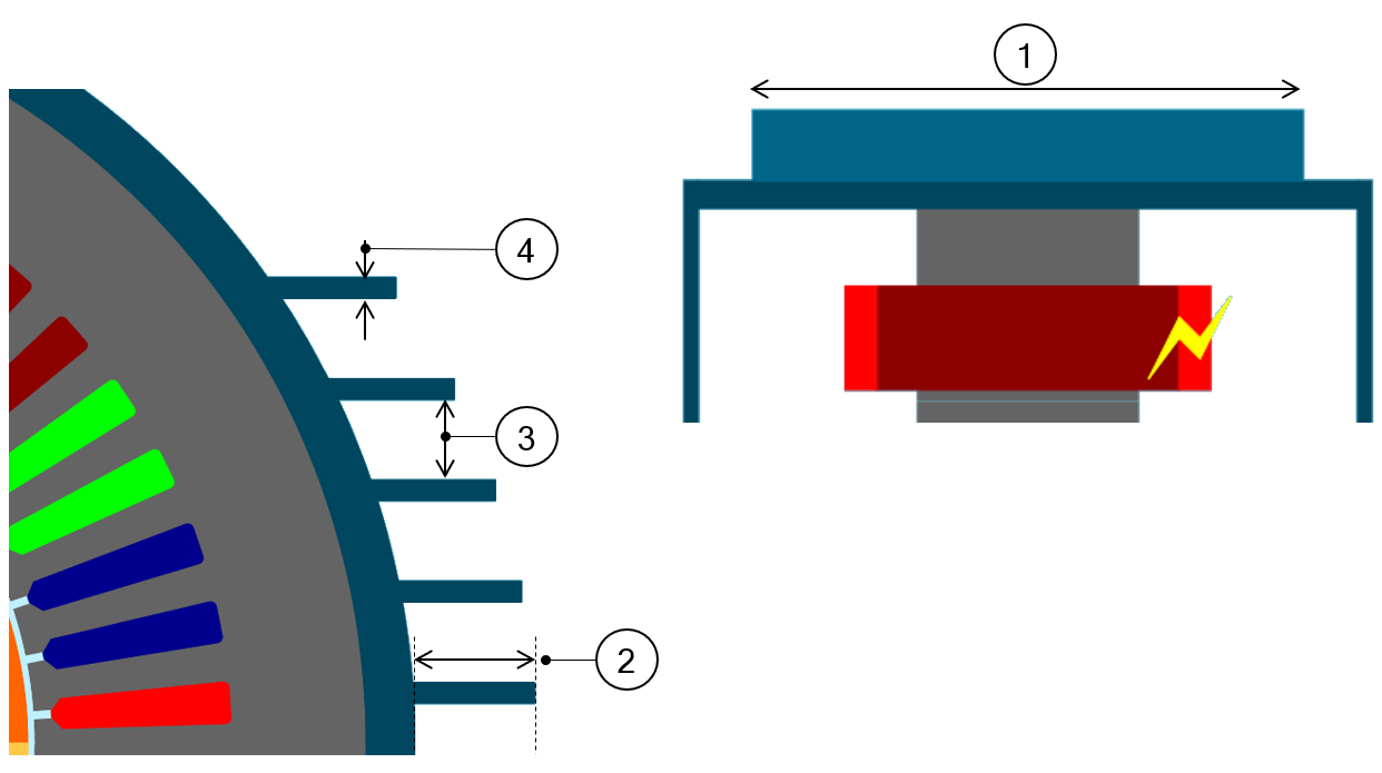

3.2 Parallel type fins with constant height – Inputs
Parallel type fin with constant height - Inputs | |
# | No. fins (Number of fins) which spread all around the housing – Minimum allowed value = 12. |
1 | Fin length |
2 | Fin height |
3 | Inter-fin space |
4 | Fin thickness |

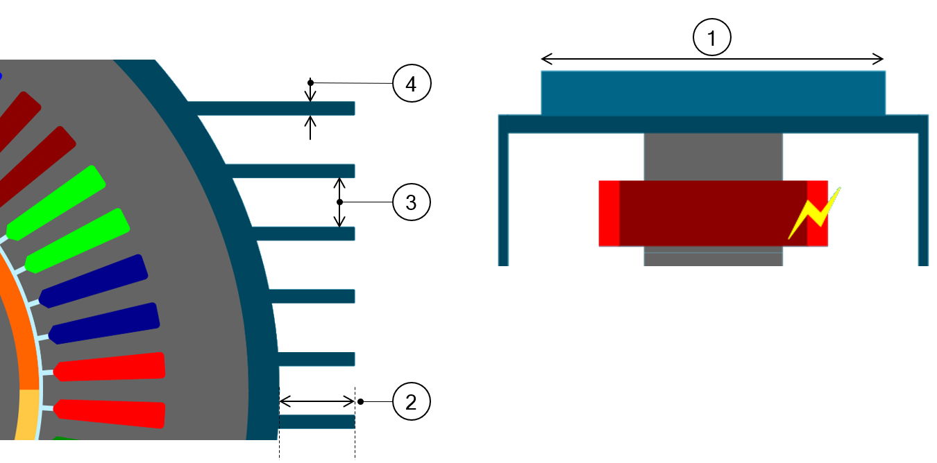

3.3 Parallel type fins with constant total extension – Inputs
1 | Fin length |
2 | Fin extension |
4 | Fin thickness |

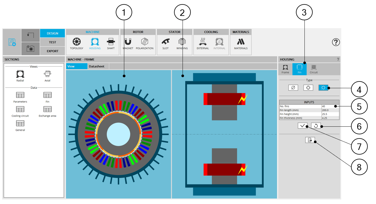

Radial type fin design area | |
4 | Selected button to define radial type fins. |
5 | User input parameters to define the fin characteristics. For more information see below. |
6 | Button to restore default input values. |
7 | Button to apply inputs. Pressing the enter key twice applies inputs too. |
8 | Icon to export frame data into *.txt or *.xls files. |

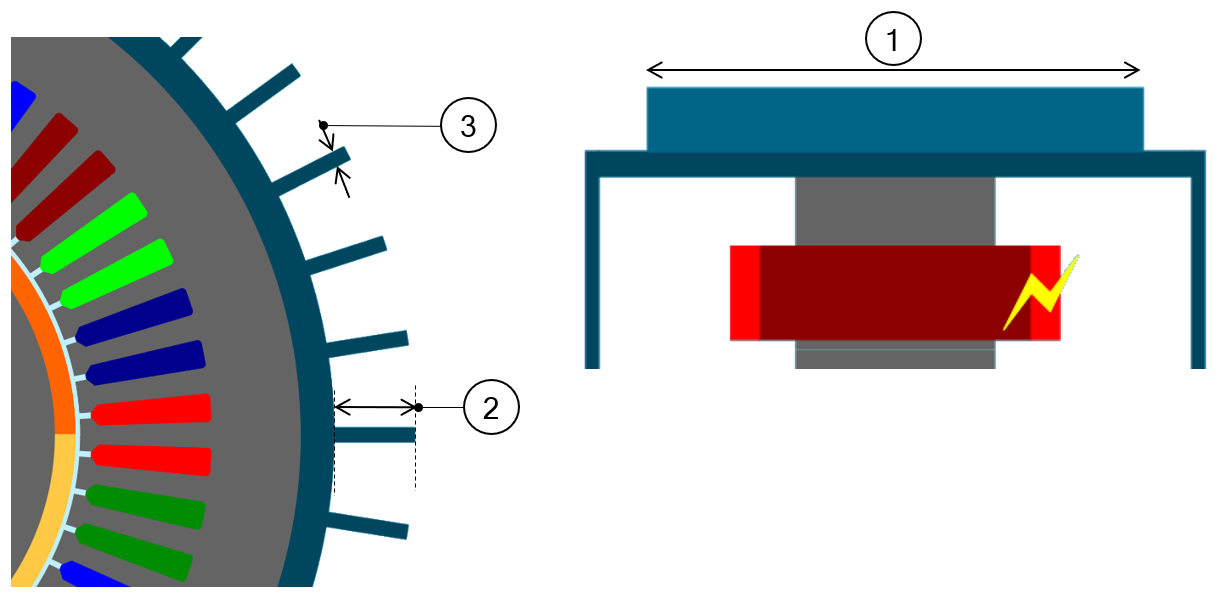

1 | Fin length |
2 | Fin height |
3 | Fin thickness |
