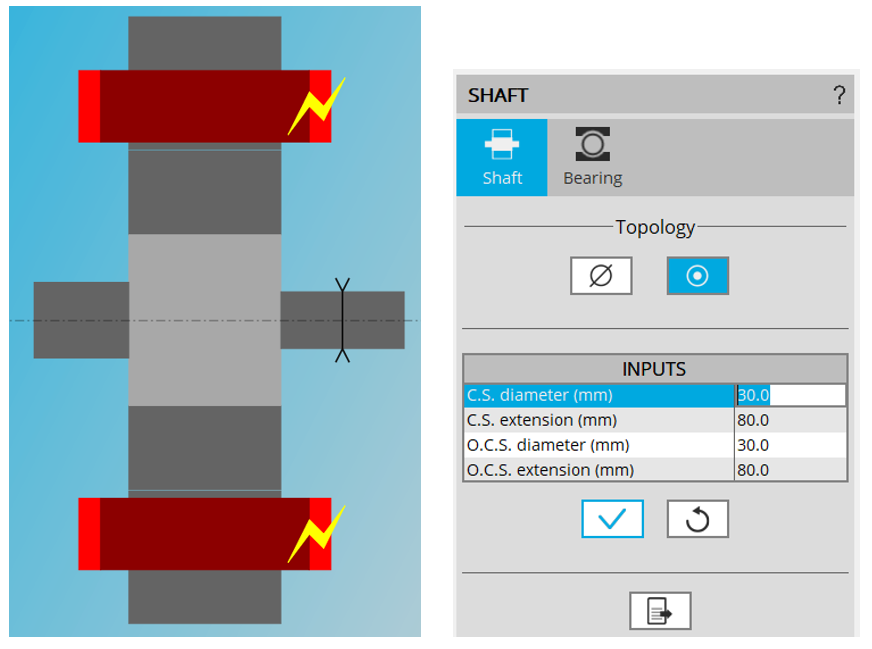

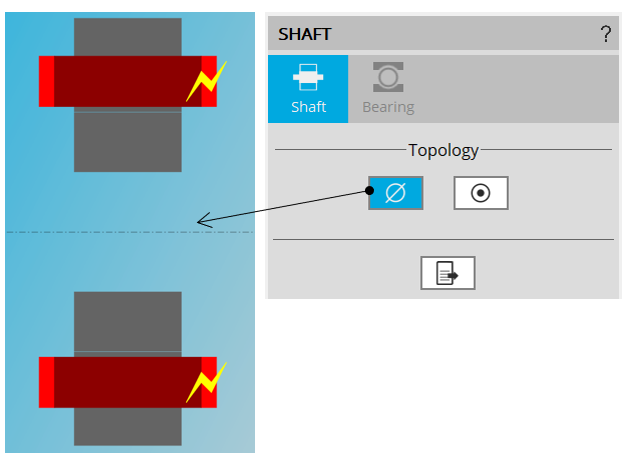

Two types of shaft can be selected:
None: No shaft represented in the rotor design.
It is replaced by a gas (like air).
Solid: Shaft is represented and considered in the rotor design.
It is built with a solid material or laminations.
Shaft type: None | Shaft type: Solid |

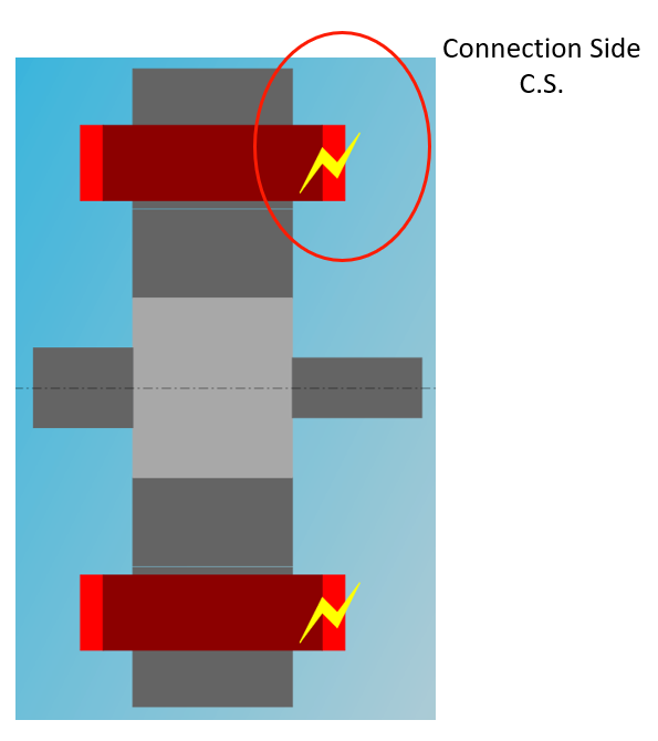

Dimensions are illustrated with arrows | Connection side (C.S.) is identified by yellow lightning. |
2. Shaft - Inputs
Label | Symbol | Tooltip, note, formula |
C.S. diameter | D1 | Connection side end-shaft diameter. |
C.S. extension | L1 | Connection side end-shaft extension. |
O.C.S. diameter | D2 | Opposite connection side end-shaft diameter. |
O.C.S. extension | L2 | Opposite connection side end-shaft extension. |
