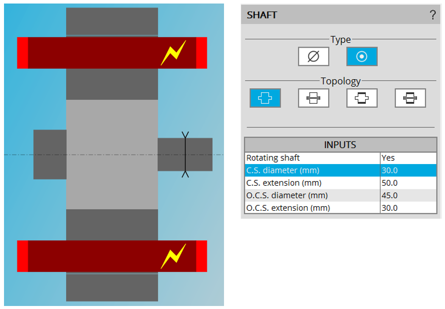

It is possible to consider a shaft or not:

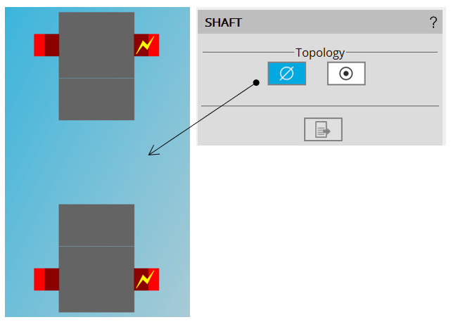

  • Type = None: No shaft represented in the rotor design. It is replaced by a fluid (like air).
  • Type = Solid: 4 different topologies of shaft can be considered in the rotor design. It is built with a solid material or laminations. The four topologies are described below.
Shaft type: None Shaft type: Solid

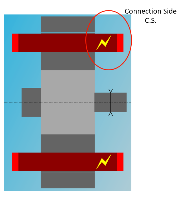

Dimensions are illustrated with arrows Connection side (C.S.) is identified by yellow lightning
