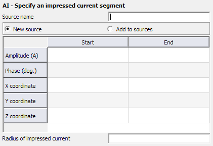

Figure 1. The AI - Specify an impressed current segment dialog.

Parameters:
- New source
- A new excitation is defined which replaces all previously defined excitations.
- Add to sources
- A new excitation is defined which is added to the previously defined excitations.
- Amplitude (A)
- Amplitude |I1| in A of the current at the start point, r1, and end point, r2.
- Phase (deg.)
- Phase of the current at the start and end points in degrees.
- X, Y, Z coordinate
- Coordinates of the start and end points in m. (Note that all the coordinate values are optionally scaled by the SF card.)
- Radius of impressed current
- This parameter is optional. If specified, and different from zero, this value gives a finite wire radius for the impressed current element. Feko then assumes that the current is uniformly distributed on the wire surface and uses the exact wire integral. If this parameter is not specified, the current filament approximation is used. (This value is optionally scaled by the SF card.)
