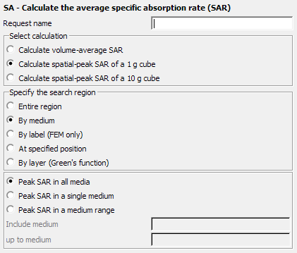

This card controls calculations of the specific absorption rate (SAR) in a dielectric.
On the Request tab, in the Solution requests
group, click the
SAR (SA) icon.
Figure 1. The SA - Calculate the average absorption rate (SAR) dialog.
Parameters:
- Request name
- The name of the request.
- Select Calculation
- One of three SAR values which could be of interest should be selected in this group.
- Specify the search region
- This group can be used to control, by medium number, label number or layer number (for the special Green’s functions), which dielectric bodies are used for the specified calculation. It is also possible to specify a user defined position for the spatial average SAR computations.
- Average/Peak SAR in all media/labels/layers
- Select this option if the selected SAR calculation should be done on a By label, By medium or By layer basis. The whole body average SAR is also calculated. Selecting the volume by label is only valid for a FEM analysis.
- Average/Peak SAR in a single medium/label/layer
- The selected SAR calculation is obtained for the medium/label specified in the Include medium/Include label dialog.
- Average/Peak SAR in a medium/label/layer range
- The selected SAR calculation is performed on the label range as specified below in the input fields for Include medium/Include label and up to medium/up to label.
- Centre of SAR cube
- For the spatial average SAR computations using a specified position, the X, Y and Z coordinates of the cube centre should be specified here.
