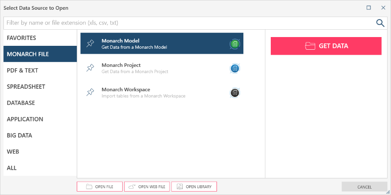

Select a data source group (e.g., Monarch File) on the left-most panel of the dialog to display the data sources under that group.

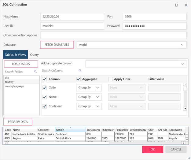

A Connection Settings dialog displays, similar to the one below:
Select a data source link below to display the dialog box options for that data source:

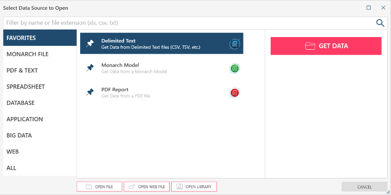

Monarch Data Prep Studio keeps track of the data sources you use most often, and provides favorites features to help you connect to these data sources more easily.
Favorites group
Monarch Data Prep Studio has a Favorites group that can display the data sources you use the most:

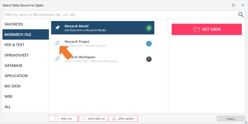

To add a data source to Favorites, click on the Pin icon beside the data source:
Once pinned, the data source becomes available on the Favorites group as well.
