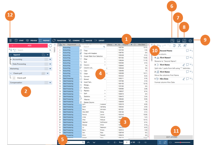

Prepare allows you to transform columns, using Prep Data operations, to prepare your data for subsequent analysis.
Prepare Window panels
Panel |
Description |
1 |
The standard Monarch Data Prep Studio Toolbar Select a tool to move to the Start Page, Preview Window, Transform Pane, Combine Stage, Analyze Drop-down, or Export Window. |
2 |
Table Selector Lists all the tables you have selected and loaded from the Preview Window. You can toggle viewing and hiding this panel by selecting the Hide/View Tables icon:
You can click on the drop-down arrow located to the right of each table to display an action menu. |
3 |
Data Preview Displays sample rows from the currently-selected table. The Data Preview panel allows you to visually confirm the data in your tables. Icons on the header readily tell you a column's data type:
You can easily change the data type of a column by clicking the data type icon and selecting a different data type from the options that display |
4 |
Prep Data Operations A drop-down list that displays when you right-click on a column or click on a column header. Select the operation from the drop-down list. Operations that display are specific to the column's data type. |
5 |
Navigation Bar Provides ways to:
Slide this slider to the left or to the right to decrease or increase the font size of the column values. |
6 |
Workspace Information Click this icon to launch a popup that provides complete details on your workspace. |
7 |
Save Workspace Use this icon to automatically save your workspace. |
8 |
Data Source Library You can save workspaces and tables to the Data Source Library. Clicking this icon displays the Library dialog. |
9 |
Settings Click to set Current Workspace or Application Default settings. |
10 |
Change History Panel Click to hide or unhide the Change History Panel and work with Change History. |
11 |
Action Bar The buttons displayed in the action bar vary according to the active table displayed in the Prepare window. You can use these buttons to perform quick operations on your table, such as edit file paths or add metadata columns. |
12 |
Application Menu Click on this button to display a menu showing additional Monarch Data Prep Studio options. You can: |
