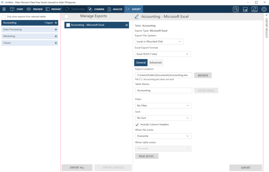

Setting up named exports
  1. Select Export from the Data Prep Studio toolbar.
    The Export Window displays:
  2. Click the Add Export button located to the right of the table you wish to export and, from the options that display, select an export format.

    The table you selected displays in the Export Management panel and its properties display in the Export Properties panel.
  3. Rename the export if you wish by clicking on the Edit button located to the left of the Export name (in the figure above, "Accounting - Microsoft Excel") and then entering a new name into the field.
  4. Specify general export options as necessary. Your export options will vary depending on the export type. The table below describes these settings.

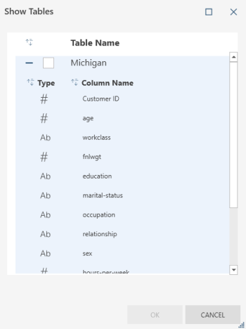

    Show Tables
    • Microsoft Excel
    • Microsoft Access
    • Panopticon
    When exporting a table to a file that already exists, this setting allows you to see the destination file’s existing tables and columns and select the table to which the data should be appended or overwritten. When a table from the Show Tables dialog is selected and confirmed, the name of the selected table is inserted into the Table Name textbox and the current content of this box is overwritten.
    The tables displayed in the Show Tables dialog may be sorted by name by clicking on the sort icon in the header. The tables have an expander button that allows you to view a list of columns belonging to that table.

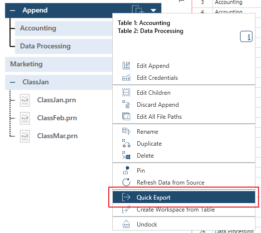

Setting up quick exports
  1. In the Prepare window, click on the drop-down arrow located to the right of a table you wish to export to display its context menu and then select Export Table from the options that display.
    Alternatively, you can select this table in the Export window, right-click on your mouse and then select Export Table.

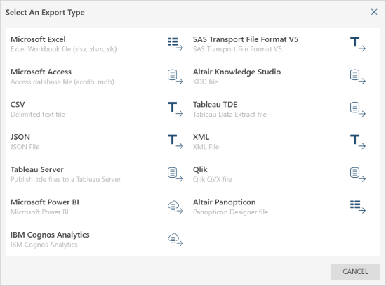

    The Select an Export Type dialog displays.
  2. Choose a file type to which your table should be exported.

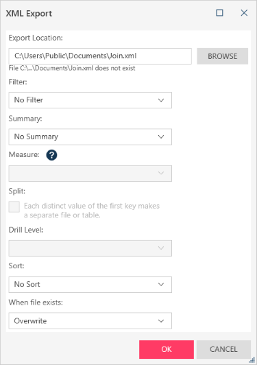

    Doing so displays an Export Properties dialog.
  3. Modify the properties of your export using the table provided above as a guide and then click OK when you are finished.

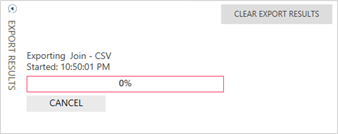

Tracking export results
The export results display in a panel located to the right of the Export window. Although hidden by default, this panel is automatically launched when an export operation is completed.
You can erase all export results from this panel by clicking on the Clear Export Results button located at the top right-hand corner of the panel.
Canceling export operations
You can cancel an export operation from the Export Results panel provided that the operation has not yet been completed.
Click the Cancel button provided to cancel a non-completed export operation.
Viewing export results
To view the exported file, click on the export link provided in the Export Results panel. A file browser pointing to the location of the exported file displays.
