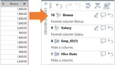

  1. By default, the Change History panel is displayed when in the Prepare window. If your Change History panel is collapsed, select it to expand it.
The Change History panel displays:

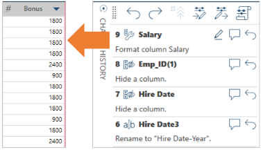

  1. Review your history of changes. If you want to undo an operation, select Undo Change beside that operation.
Note that selecting Undo for one operation will also undo all operations after it. This means if you undo change #5 in a 10-item Change History list, changes #6 to #10 are also deleted.

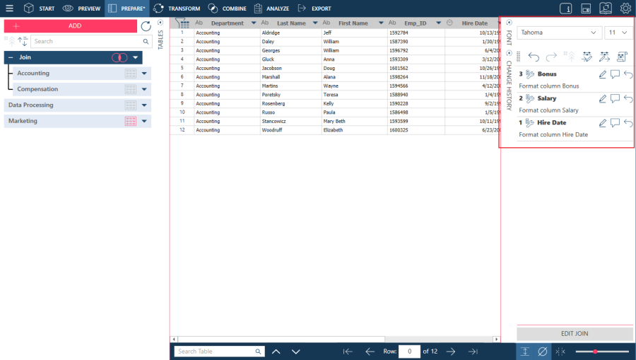

Applying changes to other columns
Monarch Data Prep Studio allows you to "reuse" changes that you have already made in conjunction with the Change History list.
To do so, drag a change from the Change History list to another column in your table.
The change is applied to the new column and a new entry is added to the Change History list.

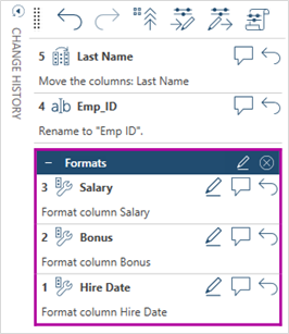

Grouping changes in a Change History list
You can group multiple changes made to a single column or multiple instances of the same change into groups to avoid creating excessively long Change History lists.
  1. Using CTRL + Click select all of the changes you want to include into a change group from the Change History list.
  2. Right-click on your mouse and, from the options that display, select Add Changes to Group.
  3. The Create Change Group dialog displays. Enter a name for the change group you wish to create and then click OK.
    The change group displays as below:

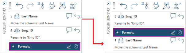

  4. Clicking the Collapse change group tool at the top of the Change History panel minimizes the group.

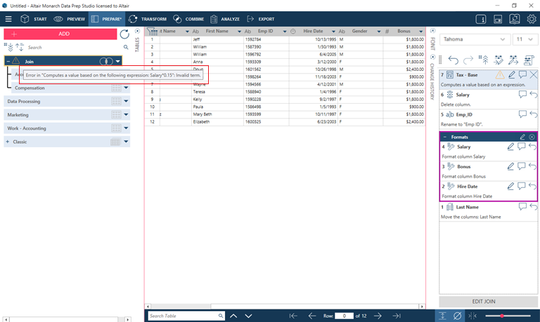

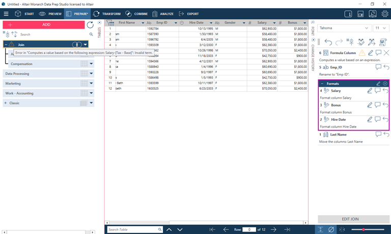

Note, however, that the success of a reordering depends on whether or not changes are dependent. When changes are dependent (i.e., subsequent changes are related to the final state of previous changes), reordering them may result in all subsequent changes becoming nullified and an error message similar to that shown below.
Deleting selected changes in a Change History list
While working with tables in Data Prep Studio, you may make a change or several changes that you decide afterwards that you don't really want but only after having made other changes that you do want. Clicking the Undo Change icon will not yield the results you desire in this case because this operation reverses all other changes, including those you want, made after the selected change.
You can easily delete changes from the Change History List without affecting other changes by pressing CTRL on your keyboard and then clicking on all of the changes you wish to delete from the Change History List. Then, right-click on your mouse and, from the options that display, select Delete Change/Delete Selected Changes.
Note that, similar to reordering changes in a Change History List, the success of deletion depends on whether or not changes are dependent. When changes are dependent (i.e., subsequent changes are related to the final state of previous changes), deleting one or some of them may result in all subsequent changes becoming nullified and an error message similar to that shown below.
