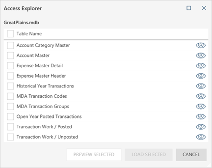

Note that when some file types, such as Microsoft Access and Excel, are used as data sources, a dialog, also referred to as an explorer, displays to ask you to specify other options prior to loading the data to your workspace.
The Access Explorer is displayed below as an example.
To continue loading your tables, indicate the necessary details and then click Load Selected.

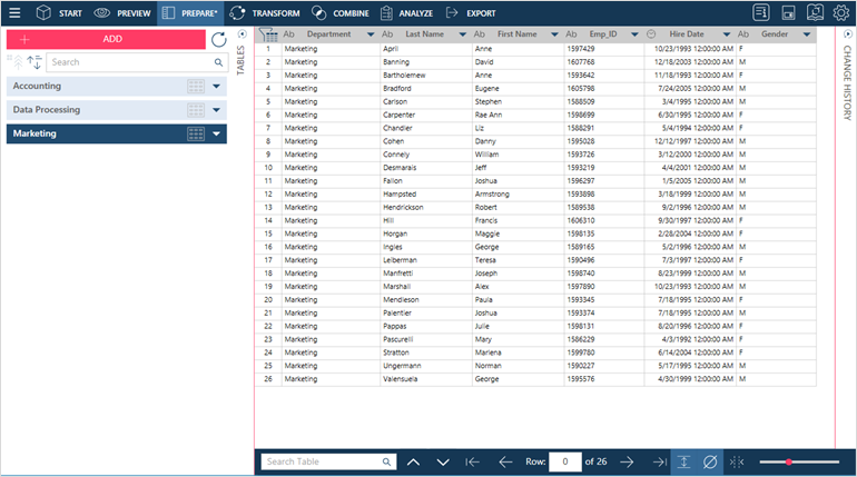

You are brought to the Prepare Window:

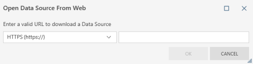

In the Select Data Source to Open dialog, click Open Web File.
The Open Data Source from Web dialog displays.
The left-hand dropdown allows you to choose the storage system in which your data resides. The possible values are:
- HTTP
- HTTPS
- FTP
- Amazon S3
- Azure Data Lake Storage Gen2
- Azure Blob Storage
- Oracle Cloud Infrastructure
- Google Cloud Storage
- Altair Monarch Server Library
Note: Credentials for cloud-based storage systems can be specified in the Server section of The Application Default Settings.
If your data source resides in the storage systems HTTP, HTTPS, and FTP, in the right-hand field, enter the URL containing your datasource and then click OK.

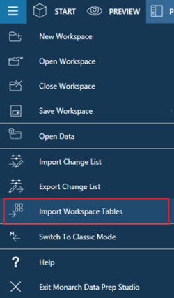

Click on the application menu icon on the upper left-hand corner of your screen and then select Import Workspace Tables from the options that display.

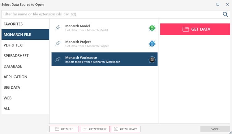

Alternatively, in the Start, Preview, or Prepare windows, select Open Data (in the Start page), New (in the Preview window) or Add (in the Prepare window) to launch the Select Data Source to Open dialog. Using this dialog, select Monarch File > Monarch Workspace > Get Data.
An Open dialog displays. Use this dialog to navigate to and select the workspace containing tables you wish to add to your table.

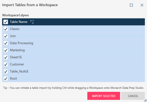

If the workspace contains a single (child) table, this table (and its parent tables) is added to your workspace. Otherwise, the Import Tables from a Workspace dialog displays. Use this dialog to select which of the tables in the workspace should be added to your currrent workspace.
Click the Import Selected button when you are finished.
The tables you selected are added to your workspace.
