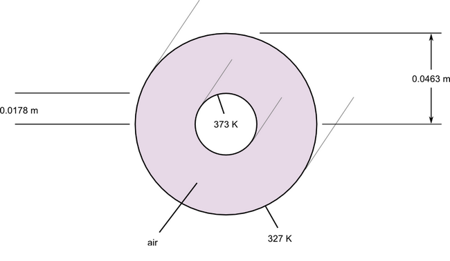

![](../../images/acusolve/natural_convection_in_a_concenf1.png)
Figure 1. Critical Dimensions and Parameters for Simulating Natural Convection in a Concentric Annulus

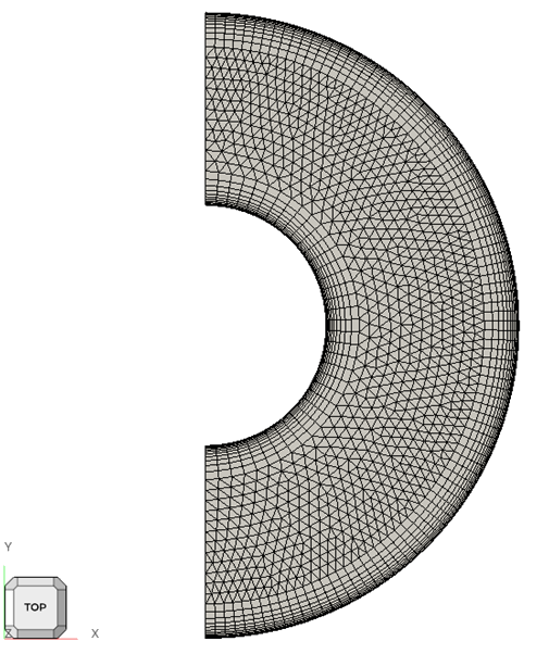

![](../../images/acusolve/natural_convection_in_a_concenf2.png)
Figure 2. Mesh (Half of a Concentric Annulus) used for Simulating Natural Convection in a Concentric Annulus

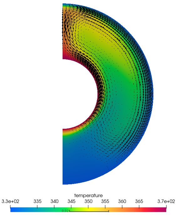

![](../../images/acusolve/natural_convection_in_a_concenf3.png)
Figure 3. Temperature Contours and Velocity Vectors

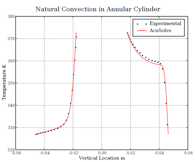

![](../../images/acusolve/natural_convection_in_a_concenf4.png)
Figure 4. Temperature as a Function of Distance From the Center of the Inner Cylinder

The AcuSolve solution compares well with analytical results for natural convection in a concentric annulus. In this application, flow is driven by a decrease in density as air is heated. The local variations in density result in the higher density fluid sinking to the bottom of the annulus while the lower density fluid rises to the top. This transfer of momentum is a continuous process which results in the convective currents that are visible in the solution. The AcuSolve temperature results compare very closely with the experimental results.
