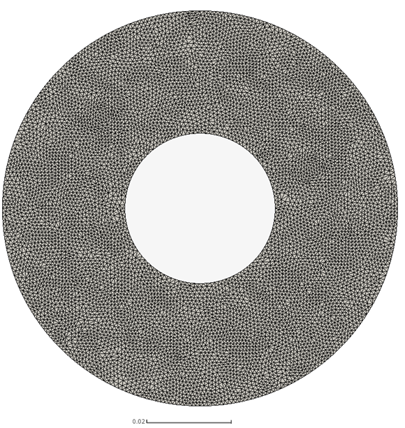

![](../../images/acusolve/flow_between_concentric_cylindersf2.png)
Figure 2. Mesh Used for Simulating Flow Between Concentric Cylinders

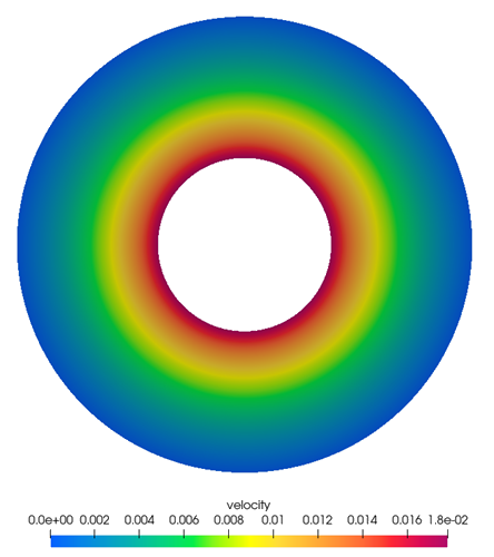

![](../../images/acusolve/flow_between_concentric_cylindersf3.png)
Figure 3. Contours of Tangential Velocity Between the Concentric Cylinders
Distance from the center of rotating cylinder (m) | Analytical tangential velocity (m/s) | AcuSolve tangential velocity (m/s) | Percent deviation from analytical |
0.020 | 0.01514 | 0.01514 | 0.04 |
0.025 | 0.01059 | 0.01058 | 0.10 |
0.030 | 0.00727 | 0.00727 | 0.06 |
0.035 | 0.00466 | 0.00466 | 0.10 |

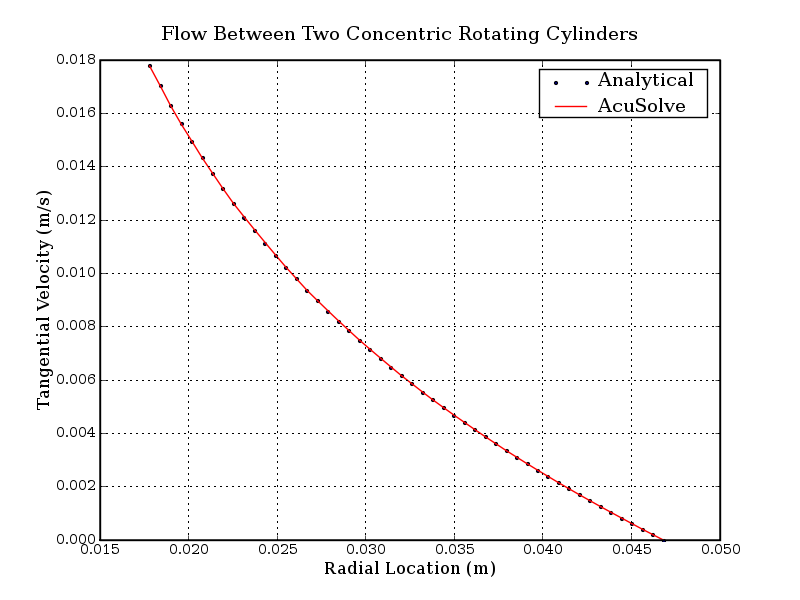

![](../../images/acusolve/flow_between_concentric_cylindersf4.png)
Figure 4. Tangential Velocity Plotted Against Distance from the Center of the Rotating Cylinder
Summary
The AcuSolve solution compares well with analytical results for the flow between concentric cylinders. In this application, the velocity in the annular fluid region is driven by the viscous stresses on the rotating wall. The AcuSolve tangential velocity is within 0.1 percent of the analytical solution at all radial locations.
