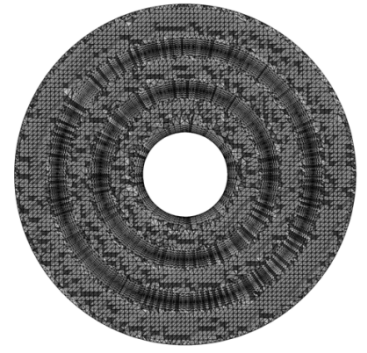

Figure 2. Mesh used for Simulating Radiation Between two Concentric Spheres
The simulation was performed as a three dimensional problem by constructing a volume mesh that contains a layer of boundary elements normal to the radial direction.

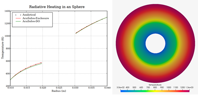

AcuSolve Results
T(r1) (K) | T(r2) (K) | Q(r1) (W) | Q(r2) (W) | |
Analytical | 578.2 | 1035.0 | -27822.5 | 12365.6 |
AcuSolve (Enclosure) | 578.4 | 1035.1 | -27827 | 12364.2 |
AcuSolve (DO) | 561.8 | 1023.6 | -26175 | 12897.0 |
Percent Difference (Enclosure) | 0.034% | 0.010% | -0.015% | -0.011% |
Percent Difference (DO) | 2.8% | -1.11% | 5.92% | 4.3% |
![](../../images/acusolve/sphere_radiation_02.png)
Figure 3. Two-Dimensional Plot and Contours of Temperature Between the Concentric Spheres
Summary
The AcuSolve solution compares well with analytical results for heat transfer due to conduction and radiation between two concentric spheres. In this application, an arbitrary material is subjected to a heat flux that is calculated based on the view factors or the DO model within the simulation. As a result of the conjugate heat transfer and the radiative heat flux a temperature distribution between the two spheres develops. The AcuSolve solution for the temperature and heat flux at the radiation surfaces matches well compared to the analytical solution with only a minor difference for the enclosure radiation model. The enclosure radiation model was found to have a higher accuracy for this application compared to the DO model, as expected due to the relatively low optical thickness in this simulation.
