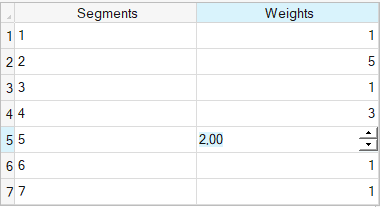

Weights for Segments
Add a weight to a segment.
To give more consideration to one segment than others, you can add a weight different from one to any segment. As a result, this segment is used multiple times for training with different seeds.
12. Weights Column
