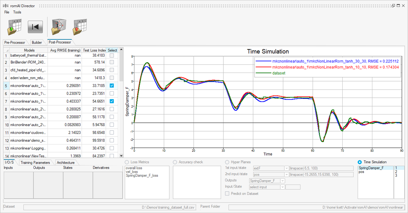

Time Simulation Tab
If romAI is used to generate dynamic ROMs, it is important to have a tool that easily performs preliminary time simulations to assess the accuracy of the transient behavior after the romAI model has been trained.
The Time Simulation tab has been designed to perform these time simulations in just one step.
Use the Import icon to select a dataset file, if not already selected. The selected dataset file name can be seen in the file name info section at the bottom of the dialog box.
注: The format and labels in the dataset file are the same as those in the training file.
A time simulation is triggered. After the simulation runs successfully, the plot is updated.
図 15. Time Simulation Plot
The following are drawn in the plot:
  • Blue line: The dynamical results produced by the romAI model, given the inputs and the initial state conditions that are contained in the dataset file.
  • Green line: The target time history.
  • RMSE Metric: Root Mean Square Error calculated between the two signals is shown in the legend.
    注: The RMSE is calculated for the segment and output currently active.
Use the list box to select the output of the romAI model that you want to plot.
If the loaded dataset file contains multiple time histories, you can select the desired history in the segments list box beside the output list box.
注: This is a preliminary time simulation. When deploying the romAI model in the Twin Activate environment, more advanced options are available.
Compare Time Simulations of Several Models
The table of models lets you select several models to compare simulation results based on the same data inputs.
Models that do not fit the first selected model cannot be selected; their check box is gray. To switch to another model, deselect all models and select the new one.
図 16. Table of Models in Post-Processor Tab

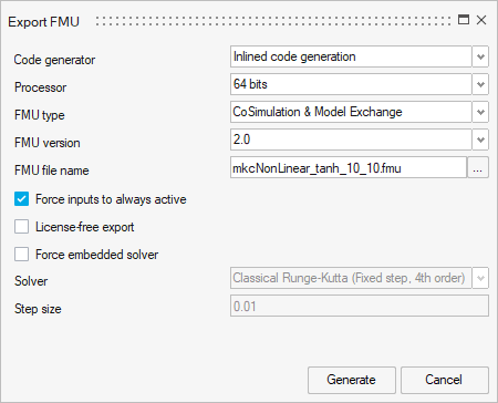

FMU Export
The FMU export tool can be accessed from Tools menu.
This option lets you generate an FMU of the romAI without creating a separate block model with a romAI block.
図 19. Export FMU Dialog Box
The parameters and options of the Export FMU dialog box are the same as in the Code Generation dialog with FMU selected as the target.
Two code generation technologies are available for selection: Standard code generation or Inlined code generation.
Both types of FMUs are supported: ME (Model Exchange) and CS (Co-Simulation).
