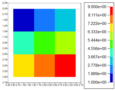

Simple imagesc example:
cla;
z = [1 2 3; 4 5 6; 7 8 9];
imagesc(z)
colorbar
図 1. Imagesc simple example

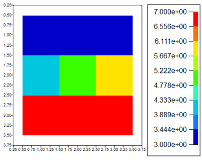

Define the range of the colormap:
cla;
imagesc(z, [3 7]);
colorbar
図 2. Colormap range set.

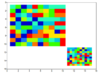

x and y may be used to scale an image:
cla;
im1 = imagesc(rand(10,10));
hold on;
im2 = imagesc(11:15, 11:15, rand(10,10));
図 4. Scaled and repositioned image.
