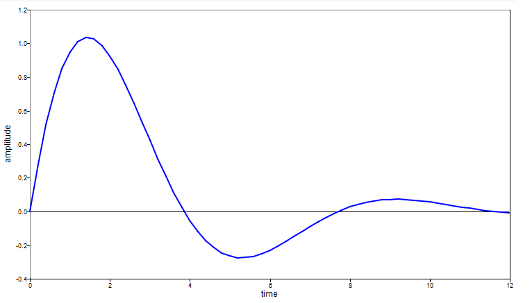

Example
Solve for the location in a mass spring damper system.
function f = MSD(t,y,yp,v,m,k,c)
  % y = [x, mD, mS]
  f = [0, 0, 0];
  f(1) = (y(2)-y(3)) - m*yp(1);  % momentum equilibrium
  f(2) = y(1) - yp(3)/k;         % displacement equilibrium
  f(3) = (m*v-y(2)) - y(1)*c;    % momentum equilibrium
end
m = 1.6; % mass
v = 1.5; % initial velocity
k = 1.25; % spring constant
c = 1.1;  % damping constant
handle = @(t,y,yp) MSD(t,y,yp,v,m,k,c);
t = [0:0.2:12]; % time vector
yi = [0, m*v,0];
ypi = [v, -c*v, 0.0];
[t,y] = ode15i(handle,t,yi,ypi);
x = y(:,1)';
plot(t,x);
xlabel('time');
ylabel('location');
図 1. chirp figure 1
