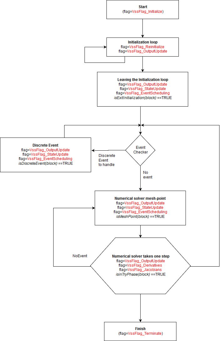

Flag Calling Sequence in Blocks
The simulator invokes the blocks with the specified flag to perform a job or a model update. In order to instantiate a block in the simulator before any subsequent call, the simulator calls all blocks with flag= VssFlag_Initialize. Just before finishing the simulation, all blocks are called with flag= VssFlag_Terminate to inform the block that this is the last call from the simulator. A simple flowchart has been given below.
図 1. Simple Flowchart Indicating Different Stages of a Simulation and Different Flags by which a Block can be Called.
