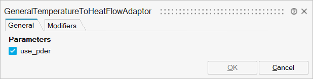

mo_use_pder | use_pder | Use input for 1st derivative of potential | Number | 0 |
mo_use_pder2 | use_pder2 | Use input for 2nd derivative of potential (only if 1st derivative is used, too) | Number | 0 |
mo_use_fder | use_fder | Use output for 1st derivative of flow | Number | 0 |
mo_use_fder2 | use_fder2 | Use output for 2nd derivative of flow (only if 1st derivative is used, too) | Number | 0 |

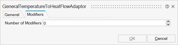

mo__modifiers/varname | Variable name | Cell of strings | 'y' | |
mo__modifiers/value | Value |
