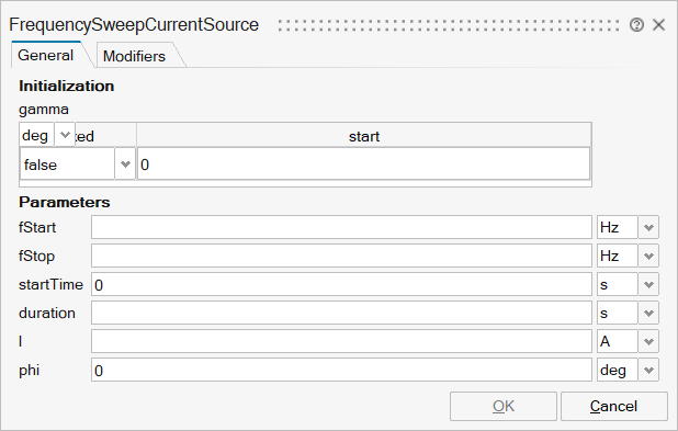

This source provides a constant RMS phase current I and phase angle phi,whereas the frequency sweeps fromfStart to fStop with duration. The frequency sweeps suchway that on a logarithmic frequency scale, the frequency curve appears linear.
mo_gamma | gamma | gamma | Structure | |
mo_gamma/fixed | fixed | Cell of scalars | true | |
mo_gamma/start | start | Cell of scalars | ||
mo_fStart | fStart | Start sweep frequency | Scalar | |
mo_fStop | fStop | Stop sweep frequency | Scalar | |
mo_startTime | startTime | Start time of frequency sweep | Scalar | |
mo_duration | duration | Duration of frequency sweep | Scalar | |
mo_I | I | RMS current of the source | Scalar | |
mo_phi | phi | Phase shift of the source | Scalar |

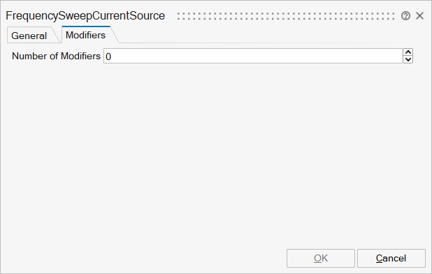

mo__modifiers/varname | Variable name | Cell of strings | 'omega' | |
mo__modifiers/value | Value |
