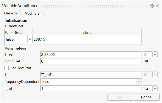

mo_T_heatPort | T_heatPort | T_heatPort | Structure | |
mo_T_heatPort/fixed | fixed | Cell of scalars | true | |
mo_T_heatPort/start | start | Cell of scalars | ||
mo_T_ref | T_ref | Reference temperature | Scalar | |
mo_alpha_ref | alpha_ref | Temperature coefficient of resistance (R_actual = R_ref*(1 + alpha_ref*(heatPort.T - T_ref)) | Scalar | |
mo_useHeatPort | useHeatPort | = true, if heatPort is enabled | Number | 0 |
mo_T | T | Fixed device temperature if useHeatPort = false | Scalar | |
mo_frequencyDependent | frequencyDependent | Consider frequency dependency, if true | Scalar | true |
mo_f_ref | f_ref | Reference frequency, if frequency dependency is considered | Scalar |

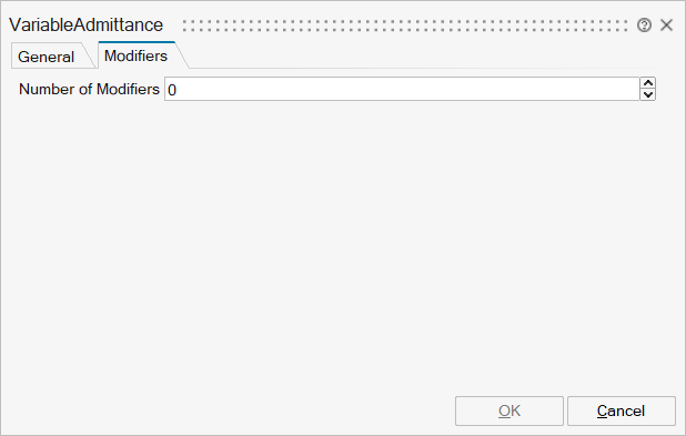

mo__modifiers/varname | Variable name | Cell of strings | 'omega' | |
mo__modifiers/value | Value |
