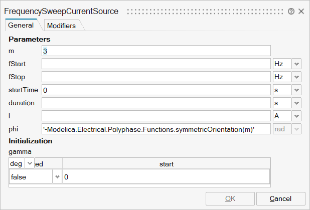

FrequencySweepCurrentSource
Current source with integrated frequency sweep
Modelica/Electrical/QuasiStatic/Polyphase/Sources
This source provides polyphase constant RMS phase currents I and phase angles phi,whereas the frequency sweeps fromfStart to fStop with duration. The frequency sweeps suchway that on a logarithmic frequency scale, the frequency curve appears linear.
FrequencySweepCurrentSource_0
mo_m
m
Number of phases
Scalar
mo_fStart
fStart
Start sweep frequency
Scalar
mo_fStop
fStop
Stop sweep frequency
Scalar
mo_startTime
startTime
Start time of frequency sweep
Scalar
mo_duration
duration
Duration of frequency sweep
Scalar
mo_I
I
RMS current of the source
Vector
mo_phi
phi
Phase shift of the source
Vector
mo_gamma
gamma
gamma
Structure
mo_gamma/fixed
fixed
Cell of scalars
true
false
mo_gamma/start
start
Cell of scalars

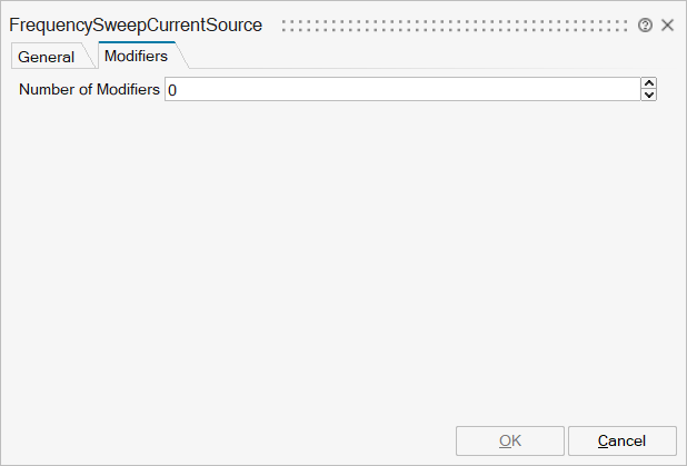

FrequencySweepCurrentSource_1
mo__nmodifiers
Number of Modifiers
Specifies the number of modifiers
Number
mo__modifiers
Modifiers
Add new modifier
Structure
mo__modifiers/varname
Variable name
Cell of strings
'omega'
'abs_v'
'arg_v'
'abs_i'
'arg_i'
'P'
'P_total'
'Q'
'Q_total'
'S'
'S_total'
'pf'
'f'
mo__modifiers/attribute
Attribute
Cell of strings
'start'
'fixed'
mo__modifiers/value
Value
