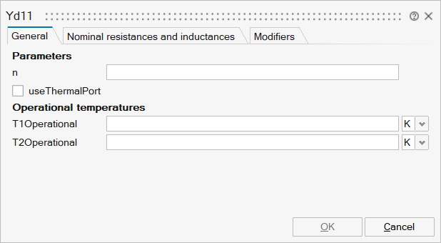

Name | Label | Description | Data Type | Valid Values |
mo_n | n | Ratio primary voltage (line-to-line) / secondary voltage (line-to-line) | Scalar | |
mo_useThermalPort | useThermalPort | Enable / disable (=fixed temperatures) thermal port | Number | 0 |
mo_ni | ni | Scalar | ||
mo_T1Operational | T1Operational | Operational temperature of primary resistance | Scalar | |
mo_T2Operational | T2Operational | Operational temperature of secondary resistance | Scalar |

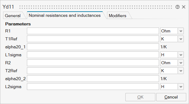

mo_R1 | R1 | Primary resistance per phase at TRef | Scalar | |
mo_T1Ref | T1Ref | Reference temperature of primary resistance | Scalar | |
mo_alpha20_1 | alpha20_1 | Temperature coefficient of primary resistance at 20 degC | Scalar | |
mo_L1sigma | L1sigma | Primary stray inductance per phase | Scalar | |
mo_R2 | R2 | Secondary resistance per phase at TRef | Scalar | |
mo_T2Ref | T2Ref | Reference temperature of secondary resistance | Scalar | |
mo_alpha20_2 | alpha20_2 | Temperature coefficient of secondary resistance at 20 degC | Scalar | |
mo_L2sigma | L2sigma | Secondary stray inductance per phase | Scalar |

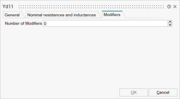

mo__modifiers/varname | Variable name | Cell of strings | 'powerBalance' | |
mo__modifiers/value | Value |
