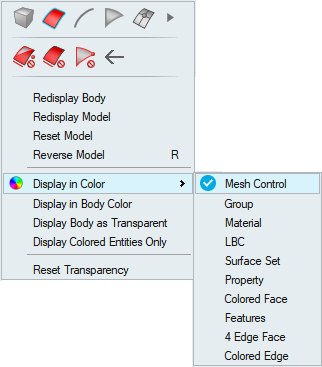

Display in Color
This option enables the color mode for Mesh Control, Group, Material, LBC , Surface Set, Property , Colored Face, Features, 4 Edge Face, Colored Edge and displays the entities in color.
The sub-menu items will be dynamically updated when Mesh control, Group, Material, LBC, Surface Set, and Property is created.

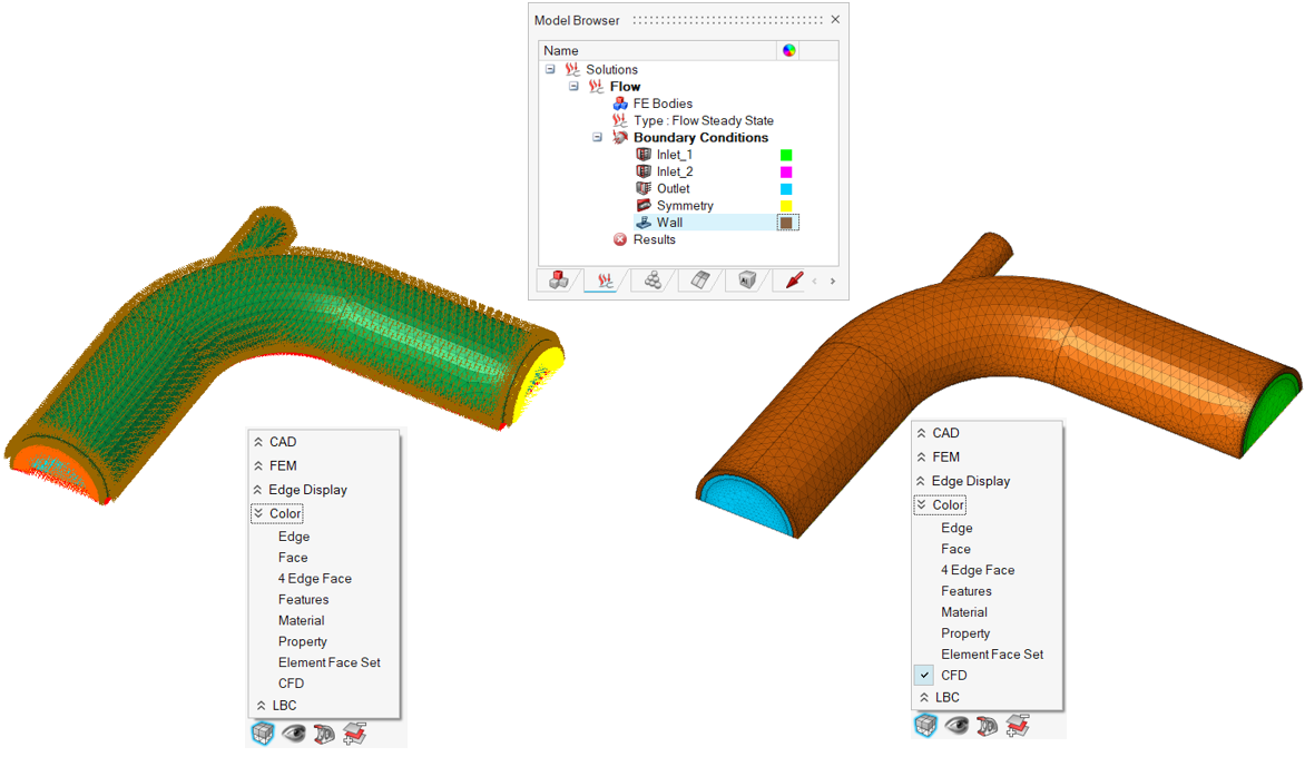

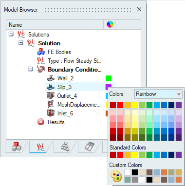

LBC
It displays the color of Boundary Conditions on its entities instead of showing markers. A random color is assigned to the entities of boundary conditions at the time of creation.
Users can change the color by using the color button in the Solution browser color column.
This color mode is supported for the boundary conditions of Acusolve,Molding and Eflo solutions. Click here for more information.

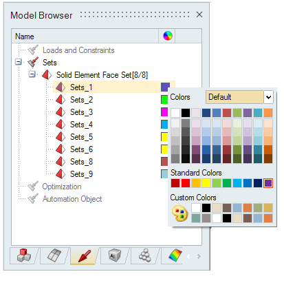

Surface Set
It displays the color of solid element face set. A random color is assigned to the solid element face set at the time of creation.
User can change the color by using the color button in the Sets browser color column.

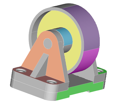

Colored Face
Display the color of face, user can set the face color by select the face and choose "Set Face Color" option in right click menu

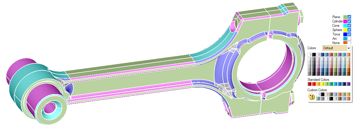

Features
It displays plane, cylinder, cone, sphere, torus and arc features with different colors. None option displays the faces, which are not part of any of the above mentioned features, in the specified color. User can change the desired colors and toggle on/off specific features.
