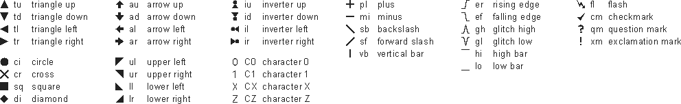

The following mark types are supported:
The format of a graphical mark attribute value is a white-space separated list of single mark definitions containing the mark type and a format string.
<name>=<type>(<color>) <type>(<color>) <name>=<type>(<color>,<bgcolor>) ... <name>=<type>(<color>,,<ratio>) ...
<name> is the mark identifier; in order to display this mark, the DB root attribute @nlv:marks=%<name> has to be set.
The <bgcolor> and <ratio> items in the format are optional, but the comma must be given, if <bgcolor> is omitted but a <ratio> is present.
Two (or more) marks can optionally be combined into more complex shapes by concatenating them with a & character like this:
<name>=<type>(<color>)&<type>(<color>)
<type> is one of the predefined mark types.
<color> is a color definition to set the (foreground) color of the mark — optionally prefixed by a + character to indicate priority over the highlight and selection colors.
<bgcolor> is an optional color definition to set the background color for this individual mark.
If not specified, the background will be transparent.
<ratio> is an optional floating point number which specifies the width:height aspect ratio of the mark.
A value of 2.0 will display the mark twice as wide as the default size, with a value of 0.5 only half the default size is used as width.
The height is always the internal default marksize and cannot be changed.
When <ratio> is omitted, a default value of 1.0 is used internally.
The marks are displayed in the same left-to-right order as specified in the attribute value.
