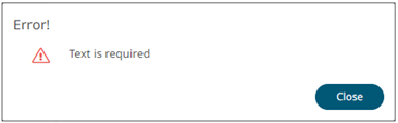

    •  An error notification displays upon column generation when the Text box is blank.
      Click Close and enter the text block.

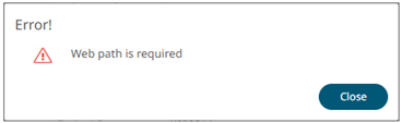

    NOTE: An error notification displays upon column generation when the Path is blank.
    Click Close and enter the web path.
