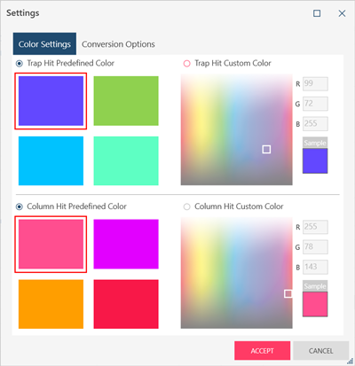

The Settings icon on the far right displays the Settings dialog that allows you to:
  • Modify color settings for trap and column hits.:
  • Set conversion options. These options are used when you load a worksheet into Worksheet Design:
