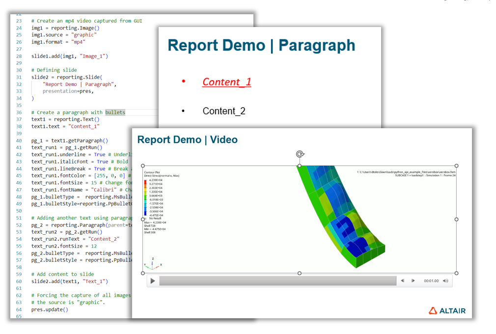

Example 03 - Creating a PPTX report with a video captured from the graphics#
After initializing the report session and presentation, two slides are defined.
For the video definition, an image object is used with source="graphic" and format="mp4".
After the video is added to the first slide, a paragraph is defined using a text object and added to the second slide.
Finally, the presentation is exported.
Note
The example requires a model and results to be loaded in the HyperView client prior to executing the code.
1import hw
2import hm
3
4import report.hwxpptxtypes as reporting
5
6session = hw.Session()
7datadir = rf"{hm.altair_home}\demos\report\data"
8
9# Initializing report session
10rep_ses = reporting.ReportSession()
11
12# Defining presentation and setting the template
13pres = reporting.Presentation()
14pres.template = f"{hm.altair_home}/hwx/scripts/python/report/io/presentation/templates/pptTemplate.pptx"
15
16# Defining slide
17slide1 = reporting.Slide(
18 "Report Demo | Video",
19 presentation=pres,
20)
21
22# Create an mp4 video captured from graphics
23img1 = reporting.Image()
24img1.source = "graphic"
25img1.format = "mp4"
26
27slide1.add(img1, "Image_1")
28
29# Defining slide
30slide2 = reporting.Slide(
31 "Report Demo | Paragraph",
32 presentation=pres,
33)
34
35# Create a text with equations
36text1 = reporting.Text()
37text1.text = "Content_1"
38
39pg_1 = text1.getParagraph()
40text_run1 = pg_1.getRun()
41text_run1.underline = True # Underline
42text_run1.italicFont = True # Bold
43text_run1.lineBreak = True # Break after line
44text_run1.fontColor = [255, 0, 0] # red color in text
45text_run1.fontSize = 15 # Change font size
46text_run1.fontName = "Calibri" # Change font
47pg_1.bulletType = reporting.MsBulletType.BulletUnnumbered
48pg_1.bulletStyle=reporting.PpBulletCharStyle.filledRoundCircle
49
50# Adding another text using paragraph
51pg_2 = reporting.Paragraph(parent=text1) # Alt: text1.addParagraph()
52text_run2 = pg_2.getRun()
53text_run2.runText = "Content_2"
54text_run2.fontSize = 12
55pg_2.bulletType = reporting.MsBulletType.BulletUnnumbered
56pg_2.bulletStyle = reporting.PpBulletCharStyle.filledRoundCircle
57
58# Add content to slide
59slide2.add(text1, "Text_1")
60
61# Forcing the capture of all images in the current presentation in which,
62# the source is "graphic".
63pres.update()
64
65# Export in the working directory with default name
66errObj, filepath = pres.savePPTX(open=True)
67
68# If status=0 then presention successfully published
69if errObj.status == 0:
70 print("Presentation is published at", filepath)
