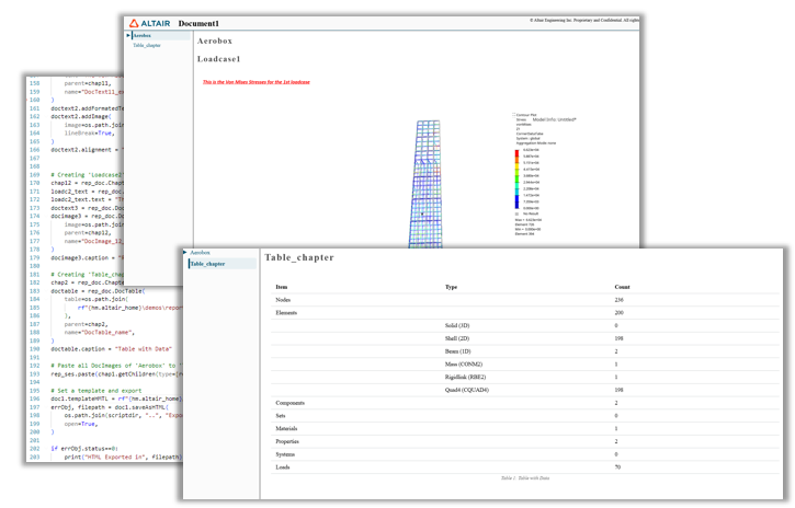

../../_images/image_doc_html_complete.png
Figure 1. Output of Example 06 from DOCX section, as HTML

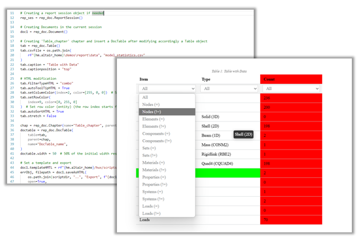

Example 02 - Creating a HTML report with tables#
In this example, a table is created and various options are set to demonstrate the capabilities of table objects. These options are:
  • Adding a filter of type combobox for the table headers.
  • Autosorting option when clicking on the table headers.
  • Values displayed in a tooltip when hovering above the cells.
  • Row and column coloring.
  • Exporting at 50% of the width defined by the template placeholder.
The table is inserted in a chapter and the HTML is exported.

../../_images/image_doc_html_table.png
Figure 2. Filtering, sorting, adding tooltip, coloring and modifying width in tables in HTML

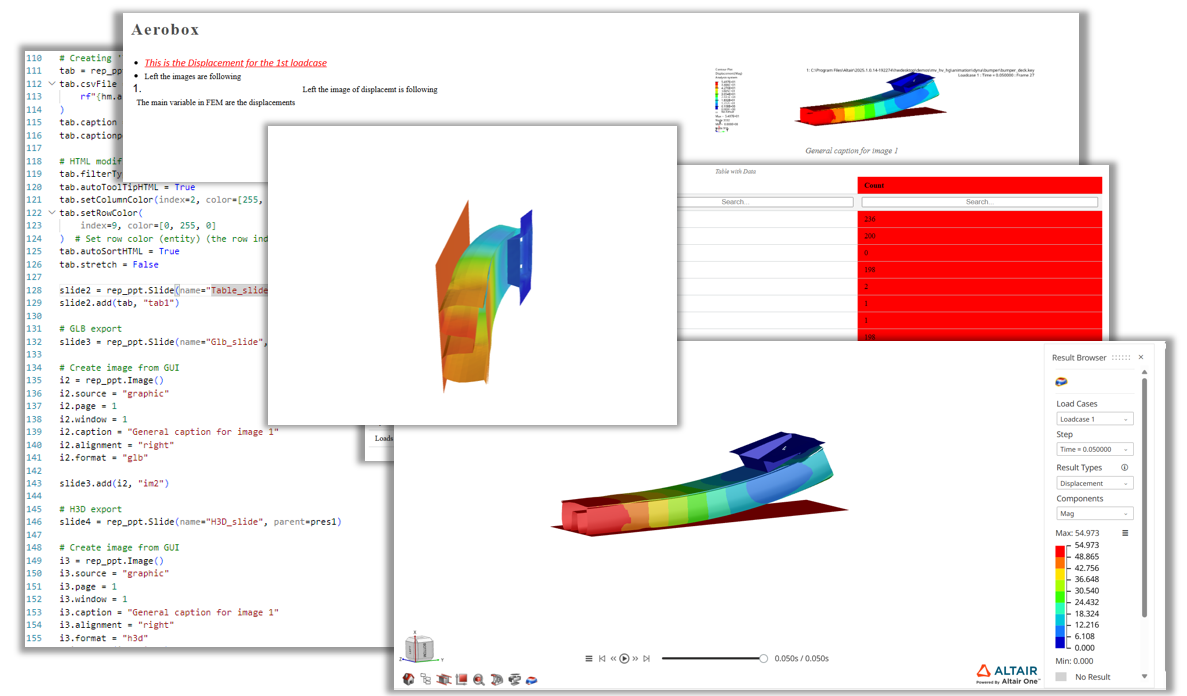

Example 03 - Creating a complete presentation-based report in HTML#
After loading a model with results in HyperView client and applying a contour plot, the report session and presentation are initialized.
First, a slide and a text object are created. Three Paragraph objects are inserted into the text object as a bullet-type list. Subsequently, a SlideText object is defined combining the slide and the text object.
Secondly, a PNG image is captured from the graphics and cropped. The image is then added to the first slide - this is possible due to the slide’s 2-window layout defined via the CSSStyle template.
Next, another slide is created containing a table with header filter as a text bar. Images slides 3 and 4 and added afterwards. Finally, the presentation is exported.

 28res.plot(resScalar)
 29# Set View
 30hw.evalHWC(
 31    "view projection orthographic | view matrix -0.021537 0.988942 0.146732 0.000000 0.872753 0.090190 -0.479758 0.000000 -0.487686 0.117728 -0.865045 0.000000 -99.918198 345.190369 584.070618 1.000000 | view clippingregion -284.806213 129.713852 528.670959 864.158752 -722.333801 601.748169"
 32)
 33# Set time step
 34animTool = hw.AnimationTool()
 35animTool.currentFrame = res.getSimulationIds()[-2]
 36
 37
 38# Creating a report session object if needed
 39rep_ses = reporting.ReportSession()
 40
 41# Creating Presentations in the current session
 42pres1 = reporting.Presentation()
 43
 44# Creating 'Loadcase1' at 'Aerobox' slide
 45slide1 = reporting.Slide(name="Aerobox", presentation=pres1)
 46
 47dispc1_text = reporting.Text()
 48dispc1_text.text = "This is the Displacement for the 1st loadcase\n"
 49
 50dispc1_text_pg = dispc1_text.getParagraph()
 51dispc1_text_run0 = dispc1_text_pg.getRun()
 52dispc1_text_run0.underline = True  # Underline
 53dispc1_text_run0.italicFont = True  # Bold
 54dispc1_text_run0.lineBreak = True  # Break after line
 55dispc1_text_run0.fontColor = [255, 0, 0]  # red color in text
 56dispc1_text_run0.fontSize = 15  # Change font size
 57dispc1_text_run0.fontName = "Calibri"  # Change font
 58dispc1_text_pg.bulletType = reporting.MsBulletType.BulletUnnumbered
 59dispc1_text_pg.bulletStyle = reporting.PpBulletCharStyle.filledRoundCircle
 60
 61# Adding another text using paragraph
 62dispc1_text_pg2 = reporting.Paragraph(
 63    parent=dispc1_text
 64)  # Alt: dispc1_text.addParagraph()
 65dispc1_text_run1 = dispc1_text_pg2.getRun()
 66dispc1_text_run1.runText = "Left the images are following"
 67dispc1_text_run1.fontSize = 12
 68dispc1_text_pg2.bulletType = reporting.MsBulletType.BulletUnnumbered
 69dispc1_text_pg2.bulletStyle = reporting.PpBulletCharStyle.filledRoundCircle
 70
 71dispc1_text_pg2 = reporting.Paragraph(
 72    parent=dispc1_text
 73)  # Alt: dispc1_text.addParagraph()
 74dispc1_text_run1 = dispc1_text_pg2.getRun()
 75dispc1_text_run1.runText = "Left the image of displacemt is following"
 76dispc1_text_run1.fontSize = 12
 77dispc1_text_pg2.bulletType = reporting.MsBulletType.BulletUnnumbered
 78dispc1_text_pg2.bulletStyle = reporting.PpBulletCharStyle.filledRoundCircle
 79
 80dispc1_text_pg3 = reporting.Paragraph(
 81    parent=dispc1_text
 82)  # Alt: dispc1_text.addParagraph()
 83dispc1_text_run2 = dispc1_text_pg3.getRun()
 84dispc1_text_run2.runText = "The main variable in FEM are the displacements"
 85dispc1_text_run2.fontSize = 12
 86dispc1_text_pg2.alignment = reporting.PARAGRAPH_ALIGN.CENTER
 87dispc1_text_pg2.bulletType = reporting.MsBulletType.BulletNumbered
 88dispc1_text_pg2.bulletStyle = reporting.PpBulletNumberedStyle.arabicDbPeriod
 89
 90slide1.cssclassidHTML = "layout-2"
 91
 92
 93# Create SlideText for slide1
 94slidetext1 = reporting.SlideText(text=dispc1_text, slide=slide1, name="sltxt1_name")
 95
 96# Take the captured image
 97i1 = reporting.Image()
 98i1.source = "graphic"
 99i1.page = 1
100i1.window = 1
101i1.caption = "General caption for image 1"
102i1.alignment = "right"
103i1.format = "png"
104i1.crop = 1
105slim = reporting.SlideImage(image=i1, slide=slide1, name="slim1_name")
106
107
108# Creating 'Table_slideter' slide and insert a DocTable after modifying accordingly a Table object
109tab = reporting.Table()
110tab.csvFile = os.path.join(
111    rf"{hm.altair_home}\demos\report\data", "model_statistics.csv"
112)
113tab.caption = "Table with Data"
114tab.captionposition = "top"
115
116# HTML modification
117tab.filterTypeHTML = "text"
118tab.autoToolTipHTML = True
119tab.setColumnColor(index=2, color=[255, 0, 0])  # Set column color (contour values)
120tab.setRowColor(
121    index=9, color=[0, 255, 0]
122)  # Set row color (entity) (the row index starts from 1)
123tab.autoSortHTML = True
124tab.stretch = False
125
126slide2 = reporting.Slide(name="Table_slide", parent=pres1)
127slide2.add(tab, "tab1")
128
129# GLB export
130slide3 = reporting.Slide(name="Glb_slide", parent=pres1)
131
132# Create image from graphics
133i2 = reporting.Image()
134i2.source = "graphic"
135i2.page = 1
136i2.window = 1
137i2.caption = "General caption for image 1"
138i2.alignment = "right"
139i2.format = "glb"
140
141slide3.add(i2, "im2")
142
143# H3D export
144slide4 = reporting.Slide(name="H3D_slide", parent=pres1)
145
146# Create image from graphics
147i3 = reporting.Image()
148i3.source = "graphic"
149i3.page = 1
150i3.window = 1
151i3.caption = "General caption for image 1"
152i3.alignment = "right"
153i3.format = "h3d"
154slide4.add(i3, "im3")
155
156# Forcing a recapture from the graphics in case of run
157pres1.update()
158
159# Export
160errObj, filepath = pres1.saveAsHTML(
161    f"{pres1.name}.html",
162    open=True,
163)
164
165if errObj.status == 0:
166    print("HTML Exported in", filepath)

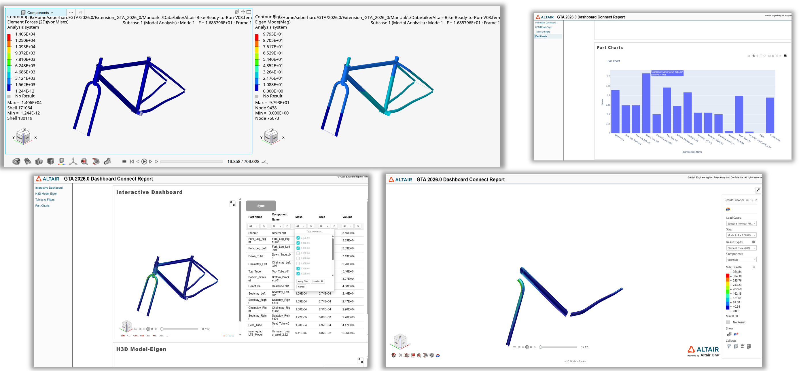

Example 04 - Synchronized H3Ds and Tables in HTML Report with Bar Chart#
First, the session file is loaded with one page and two animation windows, each displaying a bike model.
After creating the presentation, three tables and four slides are generated. The tables, sourced from CSV files, are added along with a bar chart and two H3D images.
Synchronization between one of the tables and the two H3D images is enabled using the Table.connect() method. This method requires both a list of the H3D slide image objects and the column header name of the table column containing the part names of the linked H3Ds.
A bar chart is added using the Chart() class, with its data source also being a CSV file.
Finally, the entire presentation is saved in HTML format.
 1    import report.hwxdocxtypes as rep_docx
 2    import report.hwxpptxtypes as rep_pptx
 3    import os
 4    import hw
 5
 6    sess = rep_docx.ReportSession()
 7    src_path = os.path.dirname(os.path.abspath(__file__))
 8    htmlFile = os.path.join(src_path,'.','Export','bike_report.htm')
 9
10    # CSV files for tables
11    pathUnitsystem = os.path.join(src_path,'.','bike','unitsystem.csv')
12    pathComplist   = os.path.join(src_path,'.','bike','complist.csv')
13    pathOutput     = os.path.join(src_path,'.','bike','output.csv')
14    pathOutputBar  = os.path.join(src_path,'.','bike','output_bar.csv')
15    sessionFile    = os.path.join(src_path,'.','bike','Altair_Bike.mvw')
16
17    hwSess  = hw.Session()
18    hwSess.load(sessionFile,append=False)
19
20    ppthtml = rep_pptx.Presentation("GTA 2026.0 Dashboard Connect Report")
21    ppthtml.resolution = [1000,1000]
22
23    # Create Slides
24    slide1   = rep_pptx.Slide("Interactive Dashboard", presentation=ppthtml)
25    slide1_2 = rep_pptx.Slide("H3D Model-Eigen", presentation=ppthtml)
26
27    slide2 = rep_pptx.Slide("Tables w Filters", presentation=ppthtml)
28    slideWithChart = rep_pptx.Slide("Part Charts",presentation=ppthtml)
29    slide2.cssclassid = ".layout-2"
30
31    # Create Tables
32    table1 = rep_pptx.Table()
33    table1.csvFile = pathUnitsystem
34    table1.autoToolTipHTML = True
35    table1.caption = "Table with filterType = combo"
36    table1.filterTypeHTML = "combo"
37    table1.fontsize = 24
38    table1.autoSortHTML = True
39
40    table2 = rep_pptx.Table()
41    table2.csvFile = pathComplist
42    table2.autoToolTipHTML = True
43    table2.caption = "Table with filterType = checkboxes"
44    table2.filterTypeHTML = "text"
45    table2.autoSortHTML = True
46
47    table3 = rep_pptx.Table()
48    table3.name = "Part Summary"
49    table3.caption = "Part Summary"
50    table3.csvFile = pathOutput
51    table3.filterTypeHTML = "check"
52
53    #Create Charts
54    chart1 = rep_pptx.Chart()
55    # Chart types options: "bar", "line", "scatter", "histogram", "pie" and "box"
56    chart1.type = "bar"
57    chart1.setDataSource(pathOutputBar)
58    chart1.title = "Bar Chart"
59    chart1.xData = "Component Name"
60    chart1.yData = "Mass"
61    chart1.xLabel = "Component Name"
62    chart1.yLabel = "Mass"
63
64    # Slide with H3D - 1
65    h3d1 = rep_pptx.Image()
66    h3d1.name = "H3D Model"
67    h3d1.caption = "H3D Model - Forces"
68    h3d1.source = "graphic"
69    h3d1.page = 1
70    h3d1.window = 1
71    h3d1.format = "H3D"
72
73    # Slide with H3D - 2
74    h3d2 = rep_pptx.Image()
75    h3d2.caption = "H3D Model - Eigen"
76    h3d2.source = "graphic"
77    h3d2.page = 1
78    h3d2.window = 2
79    h3d2.format = "H3D"
80
81    # Add H3Ds to slides
82    s1 = slide1.add(h3d1, "Slide1 Image 1")
83    s2 = slide1_2.add(h3d2, "Slide1_2 Image 1")
84
85    # Activate synchronisation connection to both slides
86    table3.connect(link_objects=[s1,s2],connection_column="Component Name")
87    # Add Tables to Slides
88    slide1.add(table3, "Slide1 Table 1")
89    slide2.add(table1, "Slide2 Table 1")
90    slide2.add(table2, "Slide2 Table 2")
91    # Add Chart to Slides
92    slideWithChart.add(chart1, "S1 Chart")
93    # Export HTML
94    ppthtml.saveAsHTML(htmlFile, open=True)
../../_images/image_html_table_connect_chart.png
Figure 4. Synchronized H3Ds and Tables in HTML Report with Bar Chart
